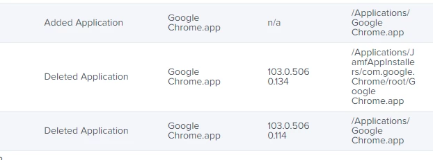

Looking through the install.log and on Jamf Pro logs I can see the old version being removed, then weridly the new version being removed , then it Adds a version with N/A version number (please see below)

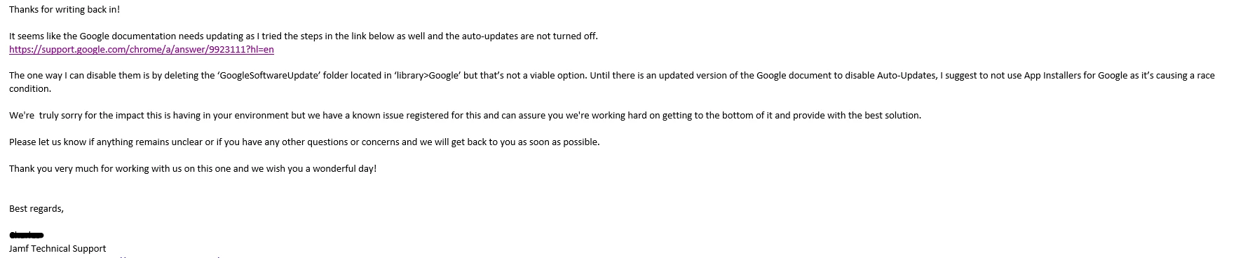

  • August 5, 2022
I have found the issue and JamF have confirmed this.
What happens is a race condition is encountered when auto updates within chrome are enabled. This causes the chrome app itself to update along with the managed app pushing an update.
This results in chrome being removed, although still reporting as being installed but showing an N/A version.
The configuration policy to disable chrome updates also does not work (confirmed by JamF support) so I have been advised not to use AppInstaller for chrome for the time being:
