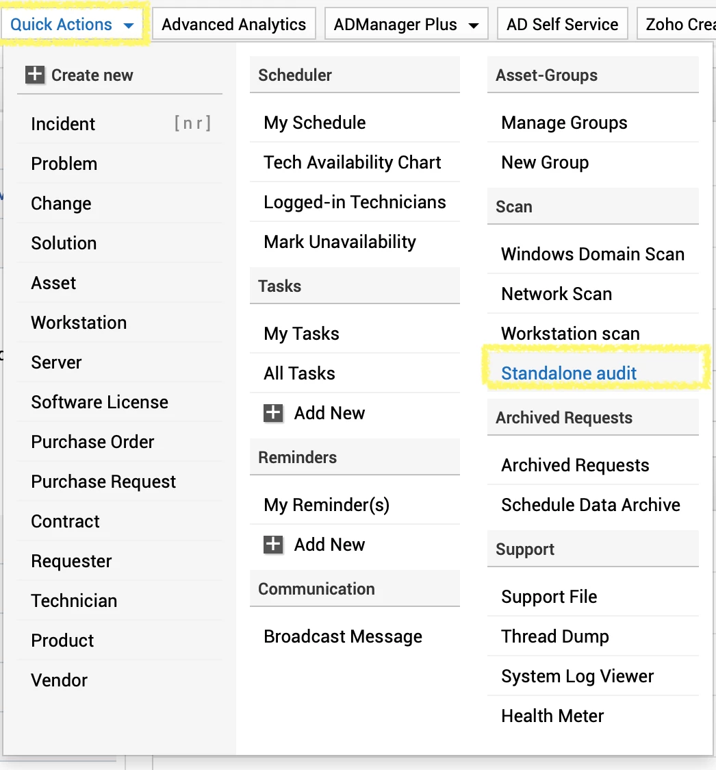

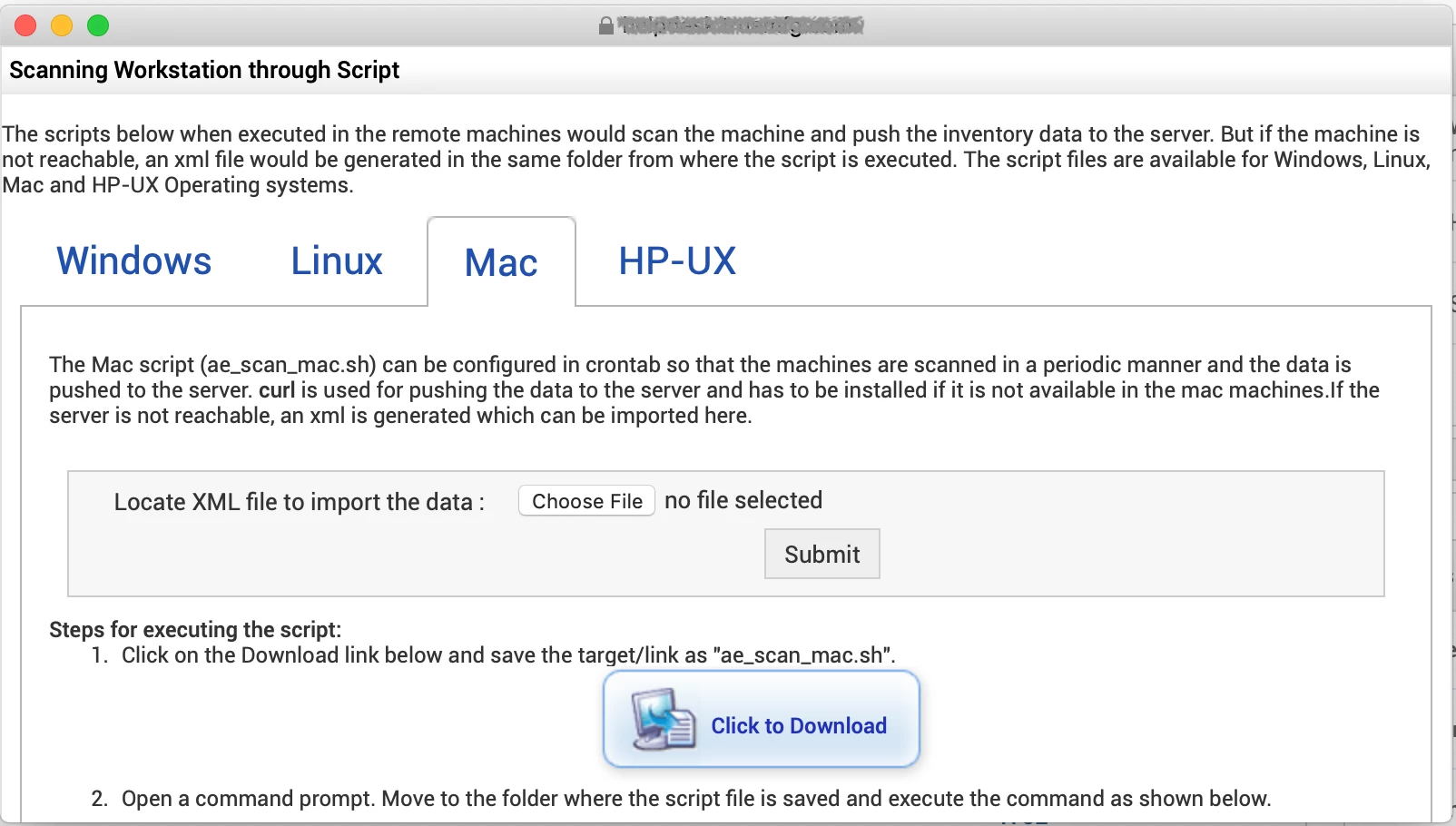

@jramm This is how I have mine setup.
  1. Download the script from your ServiceDesk console.
  2. Modify the script for your environment.
############ Server details ############
hostName="MSD69"
portNo="443"
protocol="https"
SUPPORT="assetexplorer-support@manageengine.com"
PRODUCT="AssetExplorer"
COMPUTERNAME=`hostname`
OUTPUTFILE="$COMPUTERNAME.xml"
3. Save the script and build it into a PKG and deploy with a policy. I had mine installed at /Library/SD/ae_scan_mac.sh
  1. Push this policy to all Macs.
  2. Create another policy to run this .sh script.
  3. Now Macs will scan into ServiceDesk.
