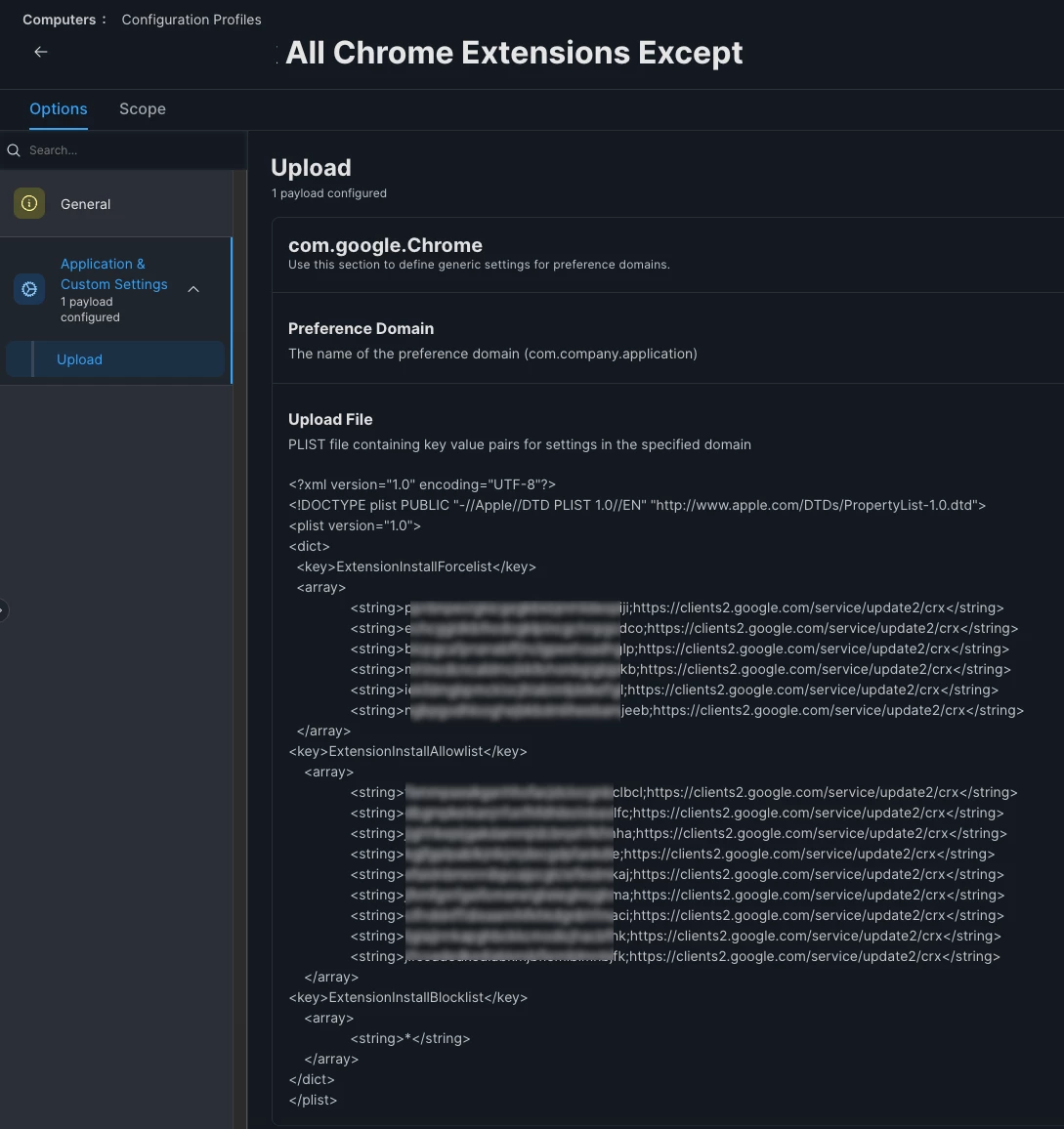

I’m deploying the google chrome extensions using the below.
Installing the forced extensions work (regardless if there is a user logged in to chrome or not)
However, one of my test computers doesnt have the user logged in to chrome and that blocks all extensions, even the ones in the allow list.
And when Im testing against my every drivers that Im logged in, I have the opposite effects. Im allow to install all extensions. and none of them are getting blocked.
I different set of eyes would be appreciated. I wish it was like some of the other post where people wait and then it works, but for me it hasnt been the case.

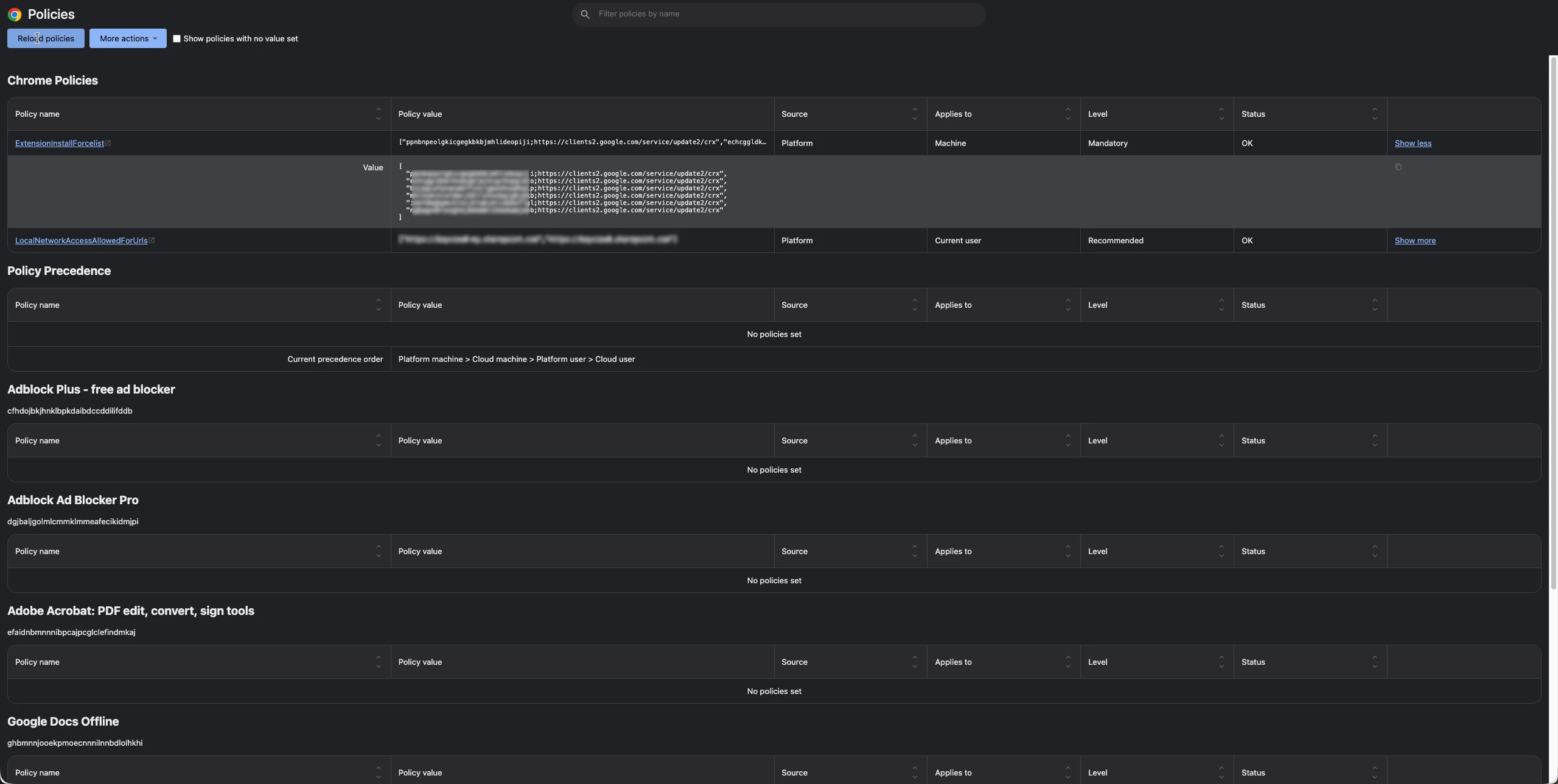

What does chrome policy say (chrome://policy). Is it seeing the configuration or is there an error?
TheCookieMonsta
when I see that in the one Im logged in it says this:
TheCookieMonsta
and the one that blocks I get this
On the upside, Chrome is seeing the policies and not throwing errors, which means your syntax is technically valid.
I’m wondering if you are hitting a Policy Precedence issue. Chrome typically prioritizes a Google Cloud Identity policy over a MDM Configuration Profile. If your users are logging into Chrome with managed identities, whatever policies are set in the Google Admin Console will take precedence and quash your Jamf configuration. Do you have any extension policies active in the Google Admin Console for these users?
Additionally, you should clean up your PLIST:
  • Forcelist: Keep the ID and URL; the browser needs the path to fetch the file.
  • Allowlist/Blocklist: Remove the URL strings and keep only the 32-character Extension IDs. Keep your allow list with just the 32-character Extension ID, and set the block list to a wildcard * to block everything not on the allow list. The browser only needs the ID to verify the "Allow" exception against your * wildcard block.

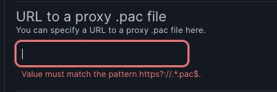

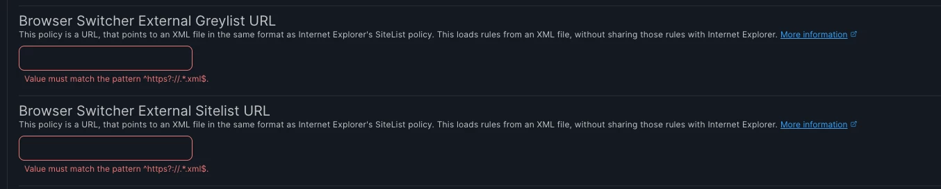

as Im trying this out, Im running a problem. we dont use a proxy and I cannot save it becase im getting red here:
and also here:
we dont use that. I think this is why I created my own. I guess I can take these sections out. or are there any default empty values that I can enter?
