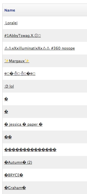

I'm curious how everyone is managing device names - I know that you can change/enforce them on a one-by-one basis or via a PreStage Enrollment but this doesn't do much for an existing deployment. Is there any way to batch change/enforce names?
If not, is it possible to hide the Device Name from display? It seems even if you remove the field from Inventory Display, it doesn't have an effect. Not sure about other deployments, but in mine, this isn't terribly useful :P

Yes, I know it was added in but like I mentioned, I was wondering if there was a method to set this setting in a batch process. Ideally it would be part of the PreStage Enrollment but the problem is we deployed before this setting was available so it's not an option. I'd be looking to set this on 700+ devices.
I was also wondering if it was possible to simply hide the name from inventory display, as it doesn't serve a purpose.
