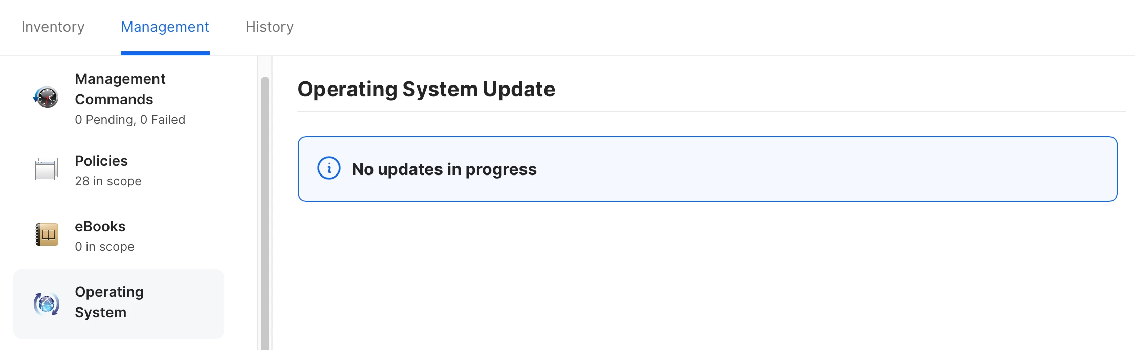

mvu
  • Nov 5, 2024 1:14 PM UTC
As mentioned devices are all running 14.6.1 so OS version isn't the issue.
Did you try turning off the new Software Update feature, then back on? This clears up a lot for my macOS and iOS stuff. You can view the status in the device logs. Management tab, Operating System.
If you see a pending update, try turning off the Software Update Feature. Revisit the logs.
When you see "No Updates in Progress," try DDM update again.

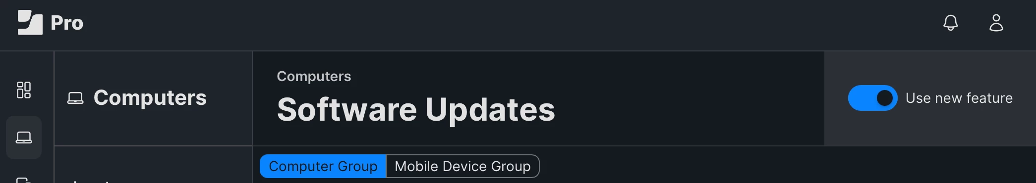

mvu
  • Nov 5, 2024 6:42 PM UTC
My Jamf instance is cloud hosted therefore I cannot see any option to turn features off and back on.
Do you see this option when you select the Software Updates item in the sidebar?

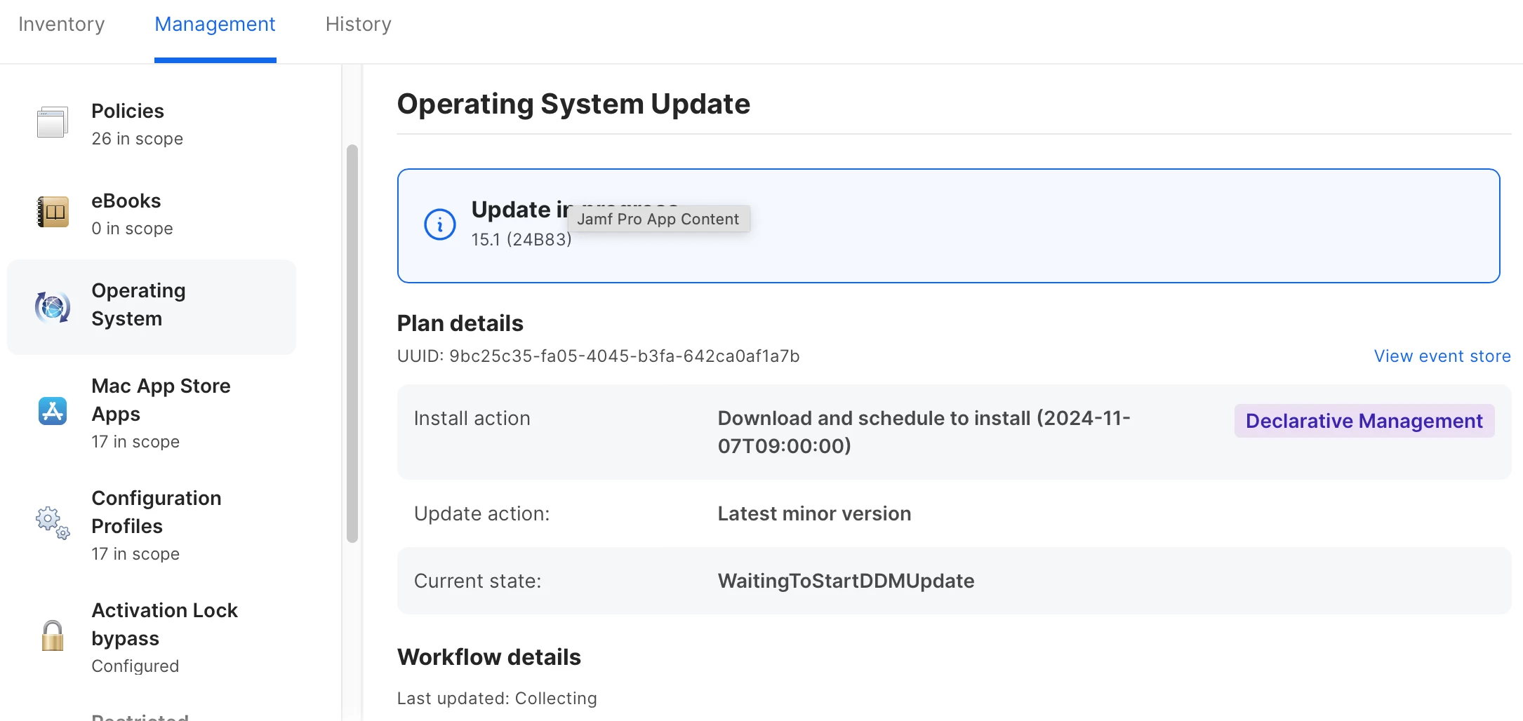

BlakeR-NZ
  • Nov 6, 2024 1:48 AM UTC
I have just found that, I gave it a try and it has made no difference. I am scheduling a minor updating for tomorrow morning, of the three outstanding devices only one device showed a notification of a pending update. All devices are currently powered on and confirmed checking in.
Device that displayed notification
Device that didn't show notification
