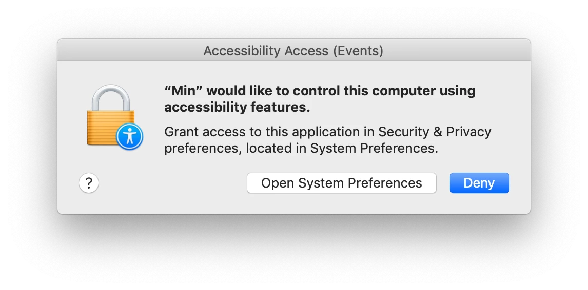

This method works for MacOS Big Sur, but not Catelina.  I might be okay with that though once Big Sur is approved on campus.  Now I just need to figure out how to enable accessibility settings with the package.  This pops up when I launch Maple 202.1
Very glad to hear this option worked for you.
Assuming you are running a minimum of JAMF 10.26. For the accessibility if you want it to be automatically accepted without user interaction you could setup a configuration profile with a Privacy Preferences Policy Control payload. You would need to know the Team ID and Bundle ID of the item you need to enable.
To obtain those if you don't have them you can run 2 lots of terminal commands over your application after it is installed.
Substituting pathtoapplication and name with actual app information the commands are :
codesign -dr pathtoapplication
 osascript -e 'id of app "name"'
Code sign gives your bundle ID code requirement and osascript gives you the identifier.
