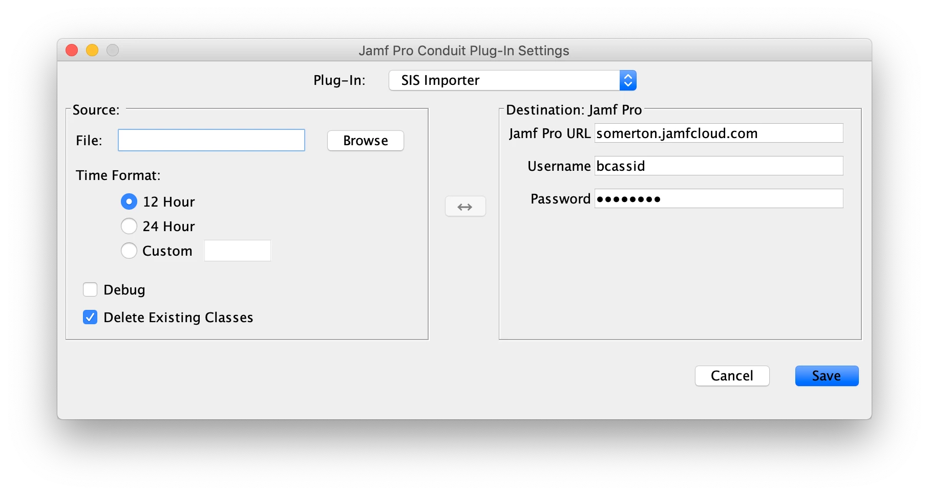

You can use the SIS Importer to delete all existing classes. You'll just need to create an export with no source file and the "Delete Existing Classes" box checked. It takes a while for it to delete them all, depending on how many classes you have, but this is the easiest way to delete all of the classes.

We delete all classes each summer and I still use the SIS Importer using the method described above by bburdeaux. It's easy to use and consistently works.

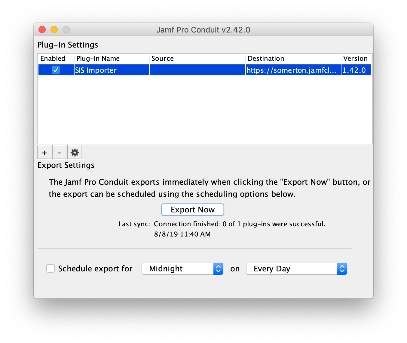

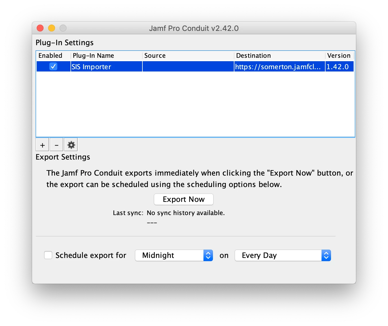

  • Aug 8, 2019 6:45 PM UTC
I tried this, but got this message: "Connection finished: 0 of 1 plug-ins were successful" and no classes were deleted. I've attached screenshots. Any help greatly appreciated.
  • Aug 8, 2019 7:02 PM UTC
Never mind. I got it to work. I had to add port 443 to the URL because if I didn't it kept defaulting to 8443 when I saved it.
