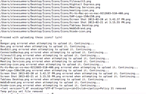

@mm2270 Hey, I was able to get around to testing this script. It didn't exactly work. Here is what it did:
-Found the icons I supplied
-Prompted me for verification
-Error'd while attempting to upload
Is there something on the JSS i need to look at, something maybe not set right?
I supplied a screenshot of the script output.
Thanks again. If I can try another version, I'll be glad to.
mm2270
  • March 10, 2017
Hey @steve.summers the only thing that comes to mind is that the API account may not have policy edit privileges on your JSS? It seems like it's able to create the policy though, and delete it at the end. So I'm not sure why it would fail to upload the images. Uploading the icons uses the edit privilege I believe.
