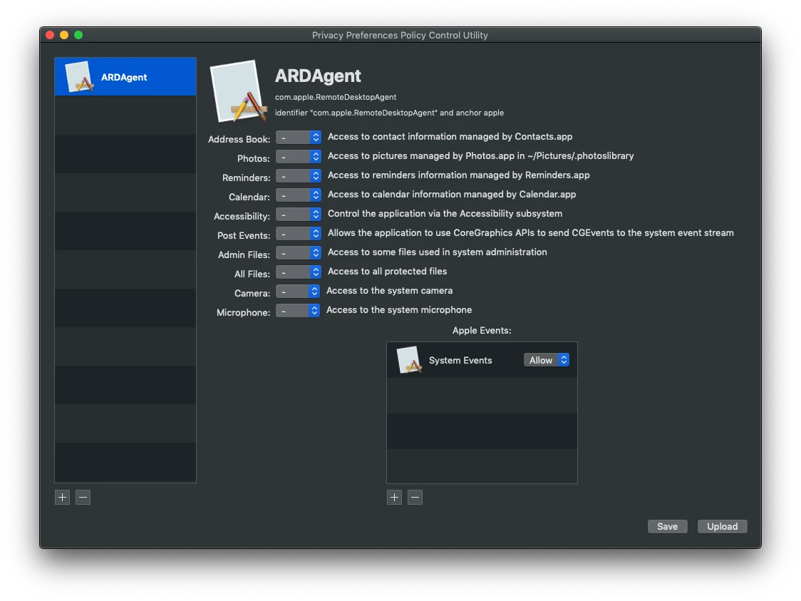

  • August 21, 2019
@annabarsu @stephaniemm77
I'm still using this with Mojave.
osascript -e 'tell application "System Events"' -e 'keystroke "username"' -e 'keystroke return'  -e 'delay 0.5' -e 'keystroke "password"' -e 'delay 0.5' -e 'keystroke return' -e 'end tell'
With Mojave you have to create a Privacy Preferences Policy Control profile to give ARD access to System Events.
I think this is all you need to set if you use Jamf's PPPC Utility, just click the plus under Apple Events to choose System Events. I ended up setting more permissions than necessary for ARDAgent so you may need to test. ARDAgent's path is /System/Library/CoreServices/RemoteManagement/ARDAgent.app if you need to find it. Upload the profile you create to your Jamf Pro server and scope it out to your Mojave Macs.
Just make sure the computers have the cursor in the username field and you run command as user root.
