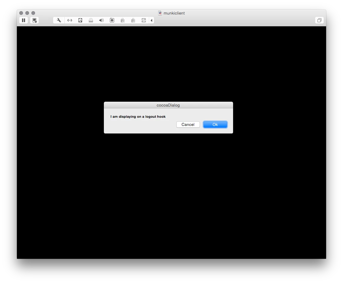

  • May 21, 2015
Try that binary again... looks like I might have cracked it... cocoaDialog.zip
sudo defaults read com.apple.loginwindow LogoutHook
    LogoutHook = "/Library/Scripts/logouthook.sh";
/Applications/cocoaDialog.app/Contents/MacOS/cocoaDialog ok-msgbox --text "I am displaying on a logout hook"
sleep 1
exit
Ya'll owe me a beer at JNUC if I fixed it.
russeller
  • May 21, 2015
I tested @loceee build of CocoaDialog with @dwandro92 script with a JSS logout trigger and it worked! Well done! Did you have to just remove the legacy code from CocoaDialog? Any other tweaks?
