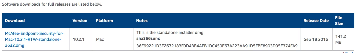

@dmw3 wrote:
there is an installer that combines all the three packages into one which we have had better luck with.
Interesting, did you have to request the combined package?
  • November 21, 2016
@donmontalvo Should be available to you via your McAfee login

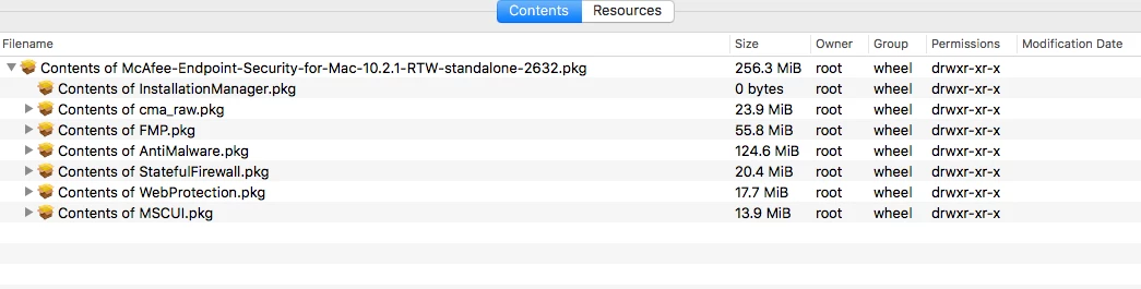

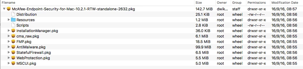

On the "all in one installer" DMG can someone post an image of the mounted DMG contents
Are there three PKGs and an install.sh? Is there a single PKG? Is there a single install.sh and a combined PKG?
Wanted to check before reaching out to the team that gets the source files for us.
TOA,
Don
  • November 22, 2016
@donmontalvo unpacked with Pacifist
  • February 28, 2017
