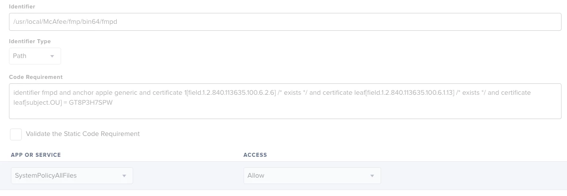

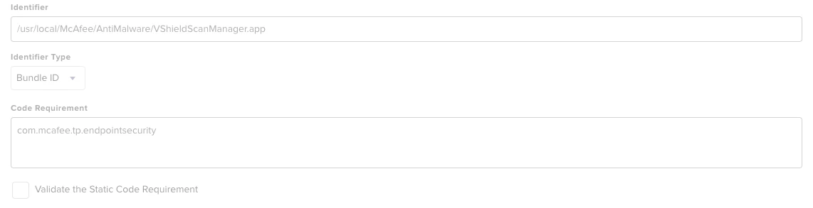

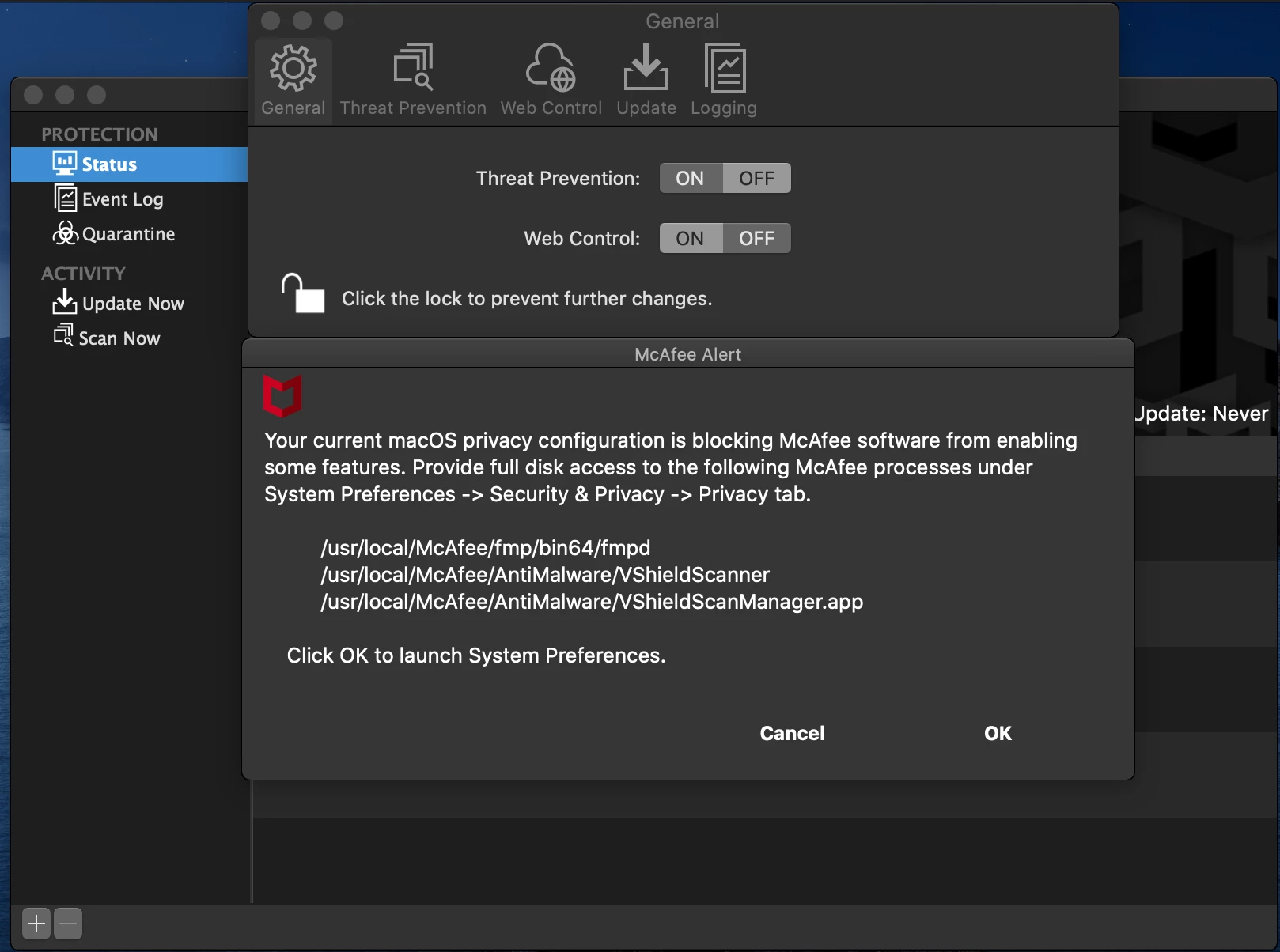

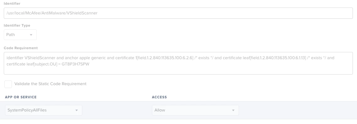

Testing out 10.7.5, Threat Prevention is disabled upon installation (this is something I have not found a fix for even in past ENS installs, I was hoping this new version would be different) however, this time when turning on TP manually, I'm met with this error:
I have a whole whitelist for PPPC in Jamf, here are the three that this popup refers to:
Any thoughts?

@mikedesmarais Looks like you haven't granted SystemPolicyAllFiles to /usr/local/McAfee/AntiMalware/VShieldScanManager.app
See https://kc.mcafee.com/corporate/index?page=content&id=KB91109 for the current PPPC requirements

@sdagley I did, my screenshot is bad I meant to include that! I'm trying to get it going with McAfee's PPPC profile from their site now, maybe I'll have better luck there.

@sdagley I ended up using the McAfee profile instead of manually entering them in Jamf and it worked like a charm. I followed the choicesXML method to forego installing Firewall and that also worked. Thanks everyone!
