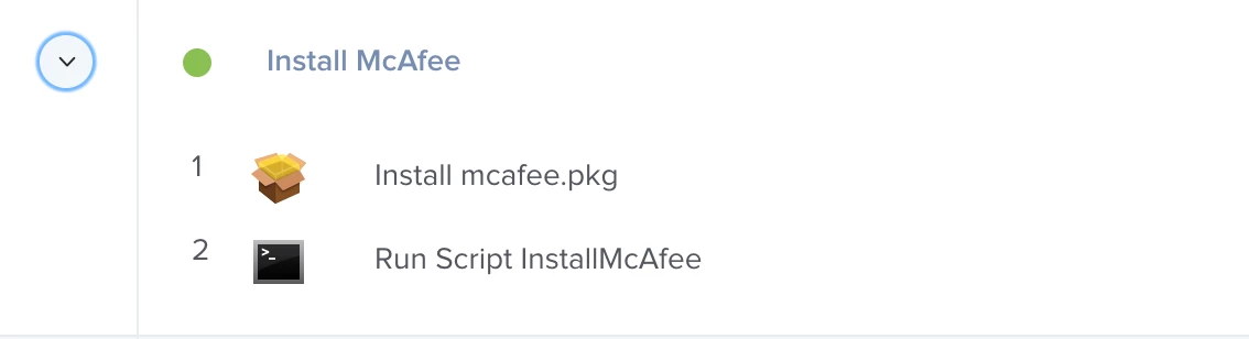

Hi, we got it working with Rob from Jamf.
For this, the install.sh script was adapted (we install threat prevention and the firewall) in 3 parts.
  1. The version 10.7.5 package of McAfee Endpoint Security
  2. the script:

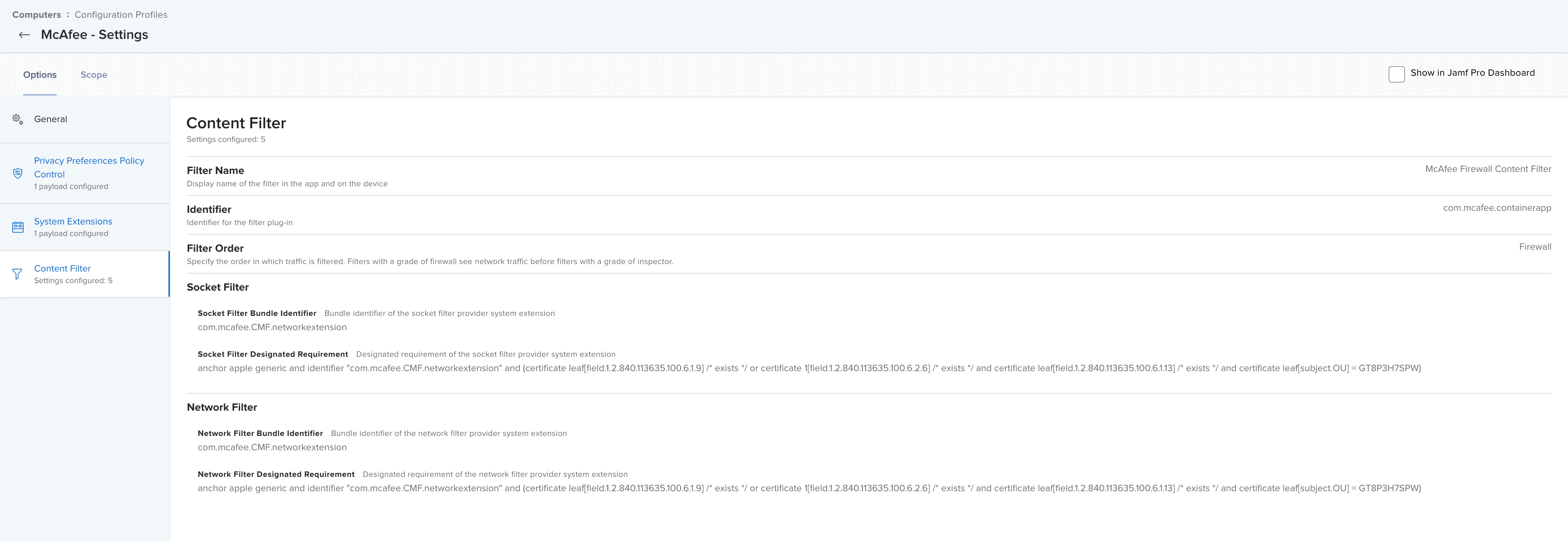

  3. the configuration profile with PPPC, system extensions and content filter (see screenshots):
PPPC:
Identifier: / usr / local / McAfee / fmp / bin64 / fmpd
Identifier Type: Path
Code Requirement: identifier fmpd and anchor apple generic and certificate 1 [field.1.2.840.113635.100.6.2.6] / exists / and certificate leaf [field.1.2.840.113635.100.6.1.13] / exists / and certificate leaf [subject.OU] = GT8P3H7SPW
Identifier: / usr / local / McAfee / AntiMalware / VShieldScanner
Code Requirement: identifier VShieldScanner and anchor apple generic and certificate 1 [field.1.2.840.113635.100.6.2.6] / exists / and certificate leaf [field.1.2.840.113635.100.6.1.13] / exists / and certificate leaf [subject.OU] = GT8P3H7SPW
Identifier: com.mcafee.tp.endpointsecurity
Identifier Type: Bundle ID
Code Requirement: anchor apple generic and identifier "com.mcafee.tp.endpointsecurity" and (certificate leaf [field.1.2.840.113635.100.6.1.9] / exists / or certificate 1 [field.1.2.840.113635.100.6.2.6 ] / exists / and certificate leaf [field.1.2.840.113635.100.6.1.13] / exists / and certificate leaf [subject.OU] = GT8P3H7SPW)

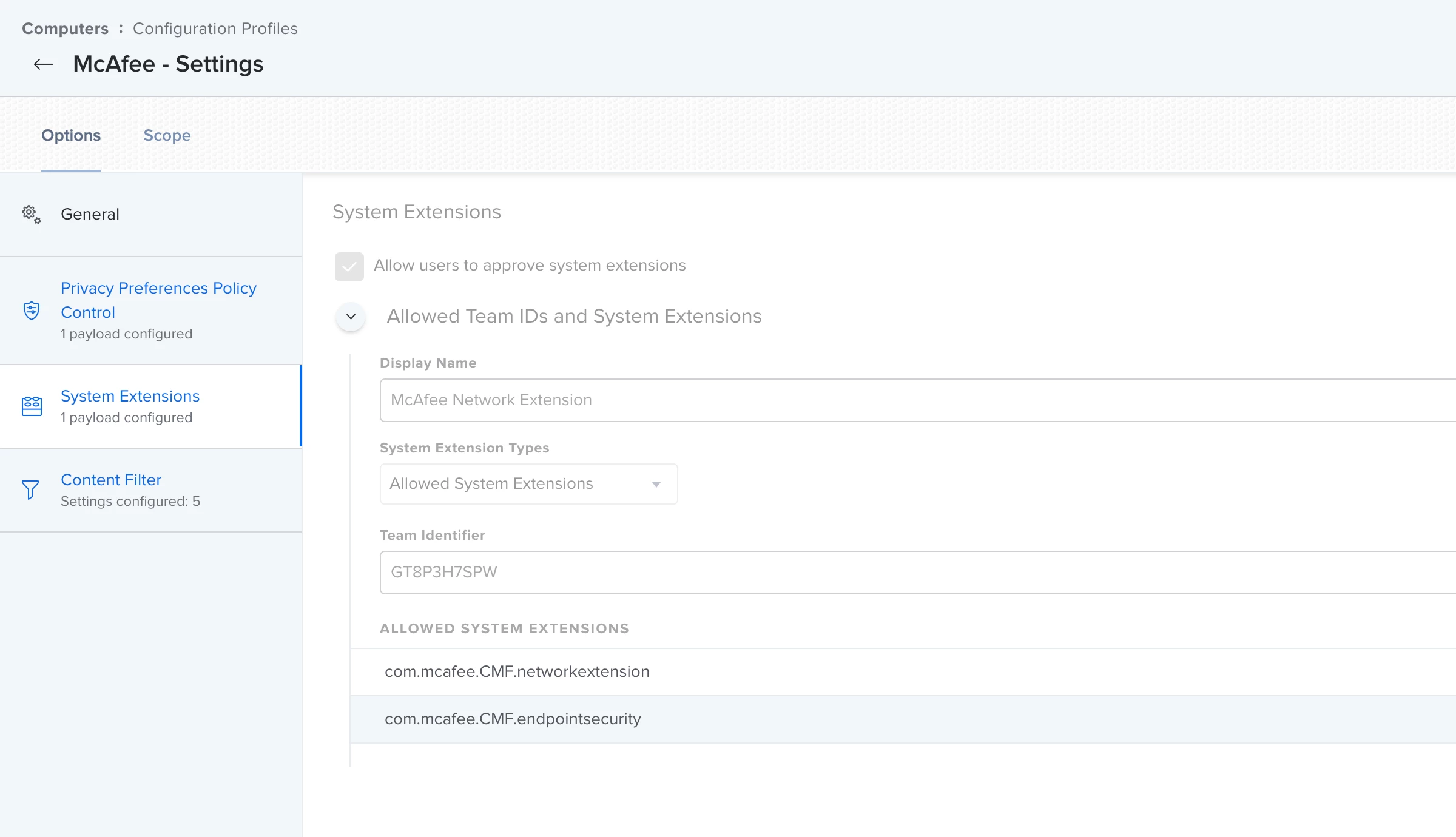

System extensions:
Allowed Team IDs and System Extensions
Display Name: McAfee Network Extension
System Extension Type: Allowed System Extensions
Team Identifier: GT8P3H7SPW
Allowed System Extensions: com.mcafee.CMF.networkextension
com.mcafee.CMF.endpointsecurity
I have attached the mobileconfig here ... McAfee mobileconfig
