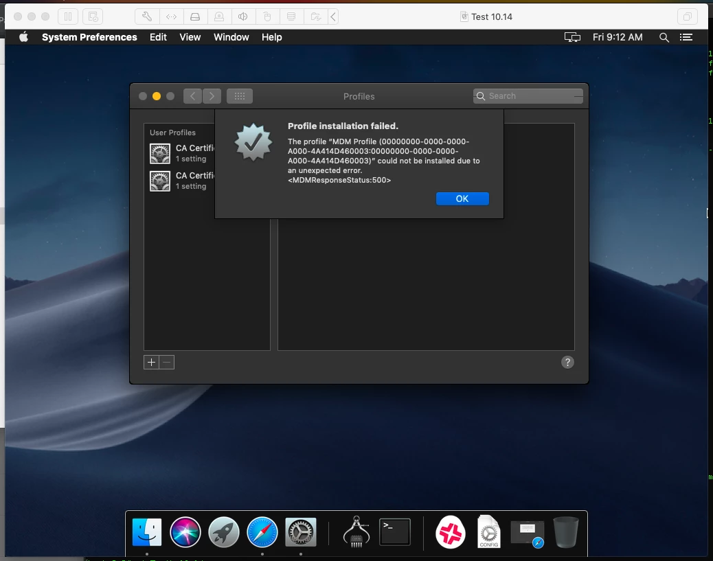

Is there an easy way to do this? I read an article about using a tool called vfuse, but it didn't seem to like the newer version of Fusion. I get an error 500 from the profile enroll window.

@mark.mahabir Hmm I tried that exact serial number - I attached a screenshot of the error I get actually. Are you setting the model to anything specific?

Just to follow up on this issue - working with a co-worker I did solve this.
What happened when I first tried enrolling the VM it got added as a mobile device (even though I got error 500's from the mdm client). After deleting that inventory record - I set the following options in the vmx file:
hw.mode.reflectHost = "FALSE"
hw.model = "blah12,0"
In VMWare Fusion 11 - the default serial number is 12 digits and works just fine. Obviously don't use blah12,0 (maybe that will work?) - I think I just set it to a Macbook model I knew could run 10.14 - and it worked. Keep in mind - its not DEP enrolled, but I don't really need that to simply test policies/packages.
I suspect the core issue is actually a JSS bug - when enrolling the device it doesn't detect it properly as a OSX device and not a IOS device. I'll contact our support rep about it.
