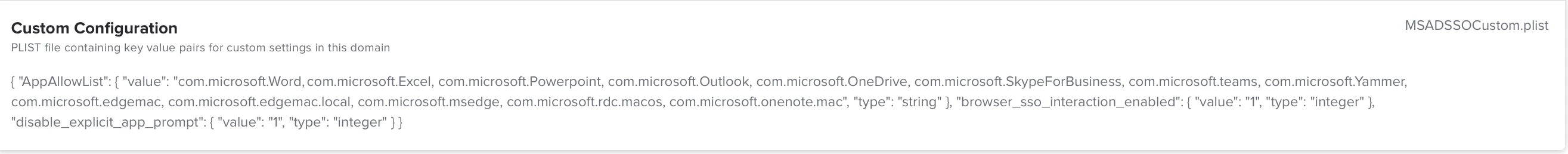

I have added all the O365 apps to the AppAllowList custom setting. Here is my custom setting PLIST that i add to the SSO Profile:
<plist version="1.0">
<dict>
    <key>AppAllowList</key>
    <string>com.microsoft.Outlook,com.microsoft.teams,com.microsoft.OneDrive,com.microsoft.Word,com.microsoft.Excel,com.microsoft.Powerpoint,com.microsoft.onenote.mac,com.jamfsoftware.selfservice.mac</string>
    <key>browser_sso_interaction_enabled</key>
    <integer>1</integer>
    <key>disable_explicit_app_prompt</key>
</dict>
</plist>
I don't think OneDrive is working yet, but it seems like all the other Apps pickup on the SSO credentials.

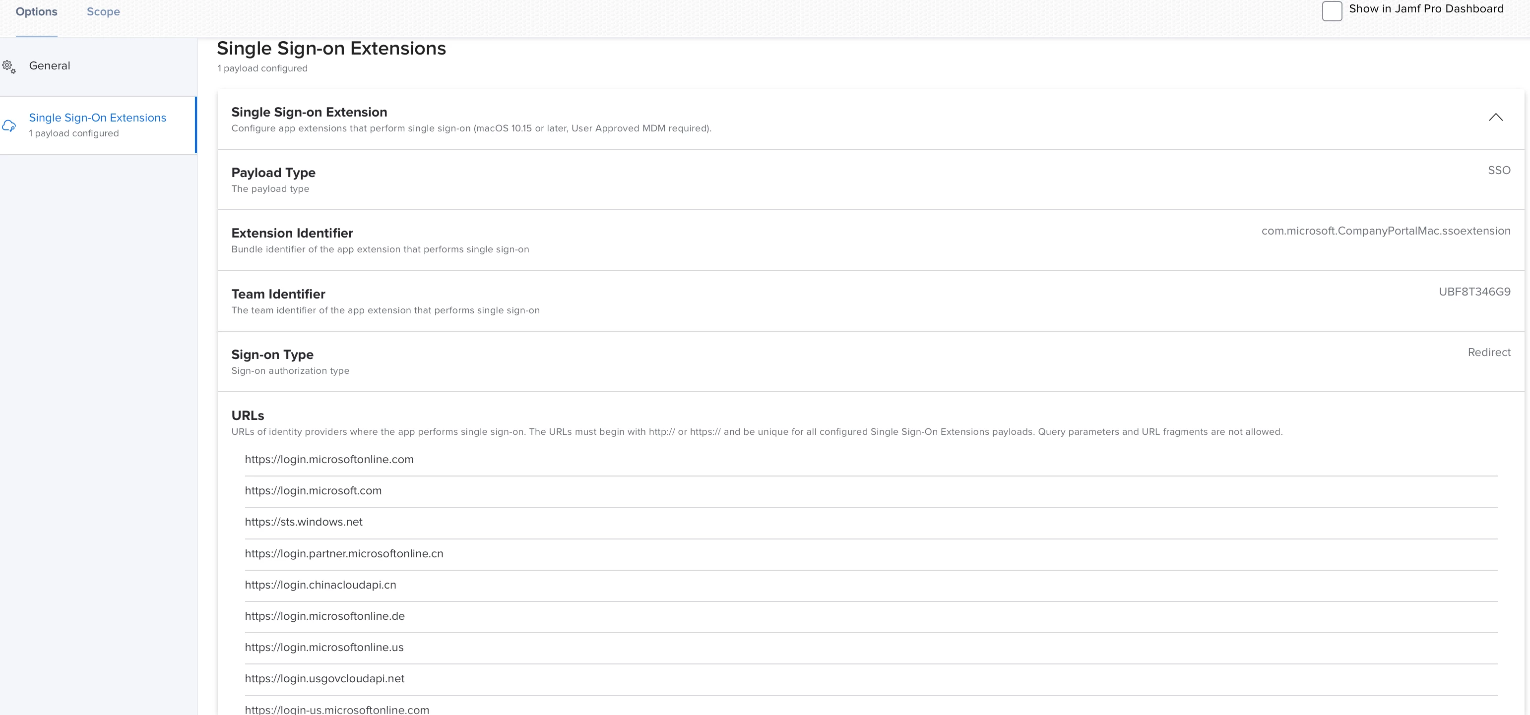

Hi ,
Sharing my configuration

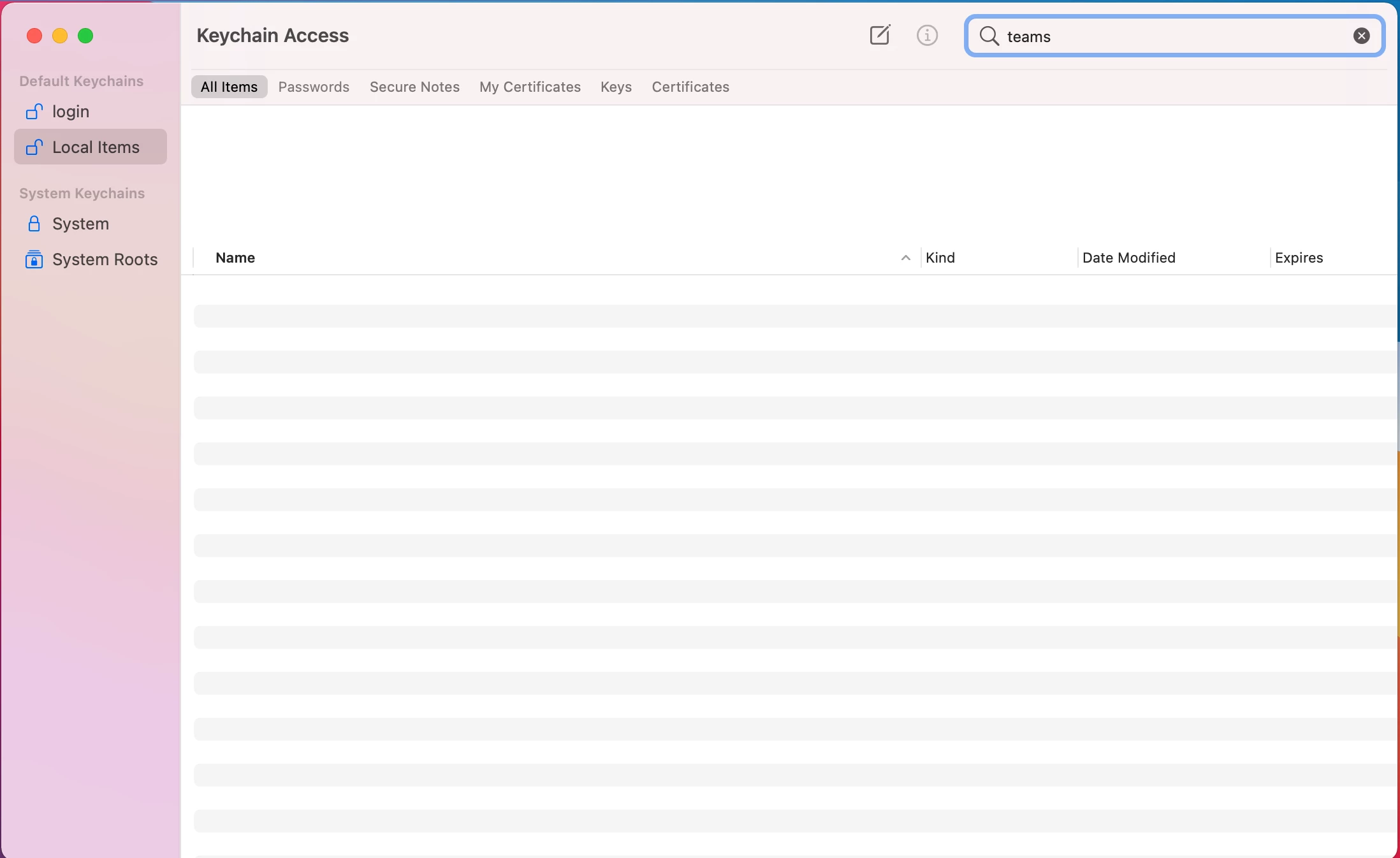

@ vinu.thankachan: this configuration enable you to single sign on in office? I seem strange: Are you sure you have not authentication in keychain?
Thanks for providing the info Vinu,
We have exactly the same configuration, as I said it works fine with Teams and Safari but not Office Apps

@vinu.thankachan Can you confirm it works (or not) for you if the Keychain and cookies are cleared ? Thanks.

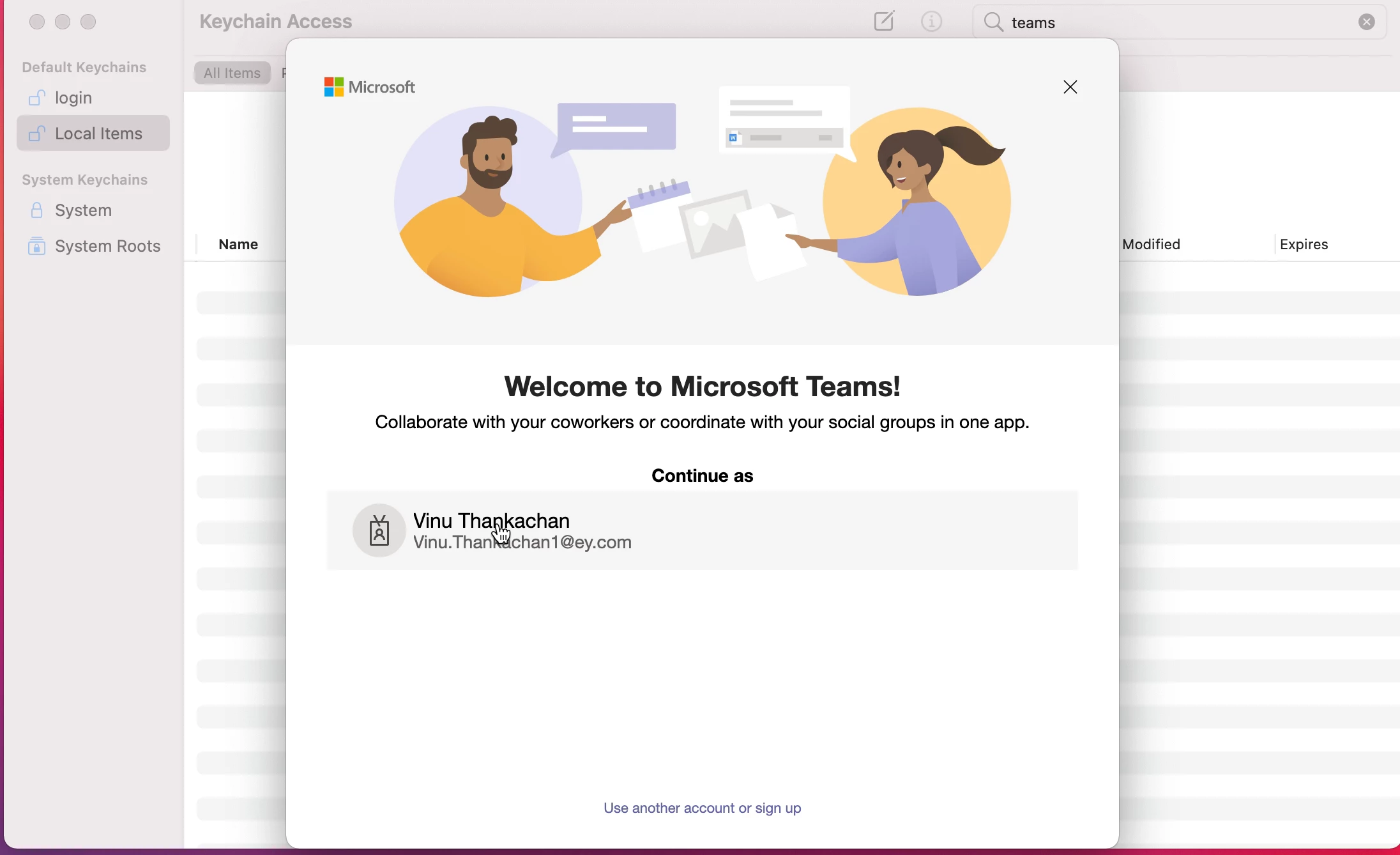

Sharing my experiance with Ms teams When I open teams for the first time, I get a prompt to choose the account. once I chose the account , Teams loads automatically

Did anyone ever figure this out? We are getting the same experience. SSO extension is configured and works with Microsoft websites, but the individual Office apps do not pick up the credentials, hence forcing us to sign into the apps manually. Teams is the only app that is close (it shows us the account selection, same as the screenshot above from @vinu.thankachan )
