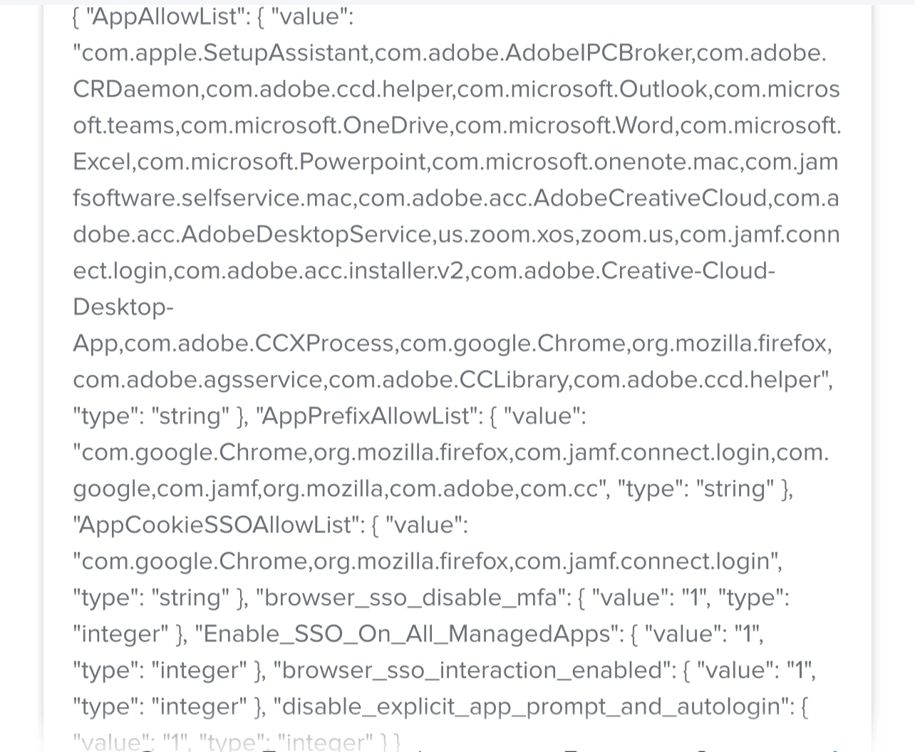

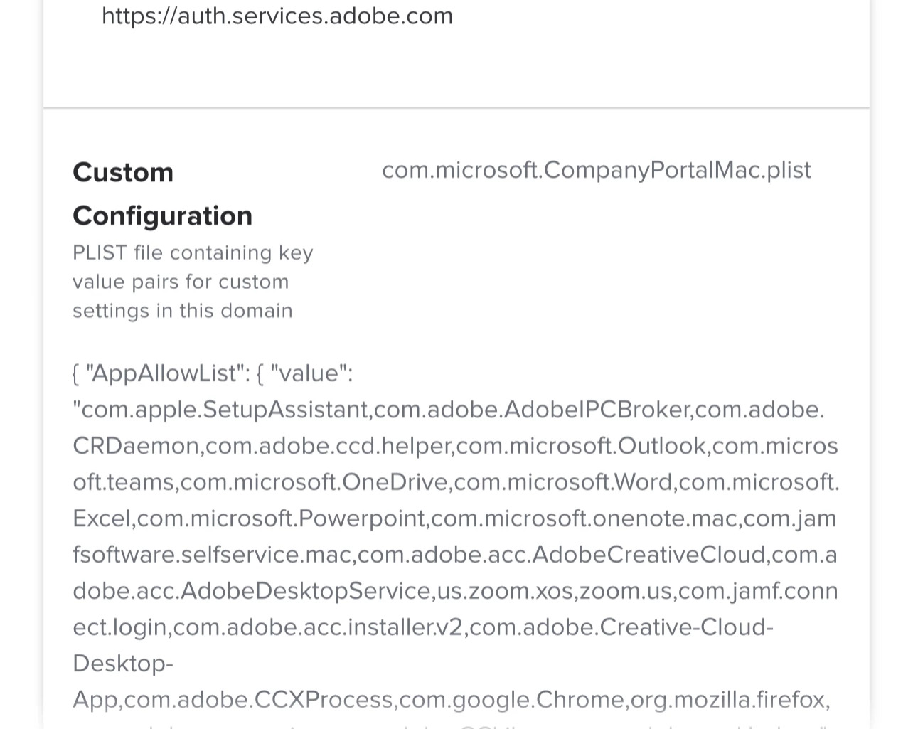

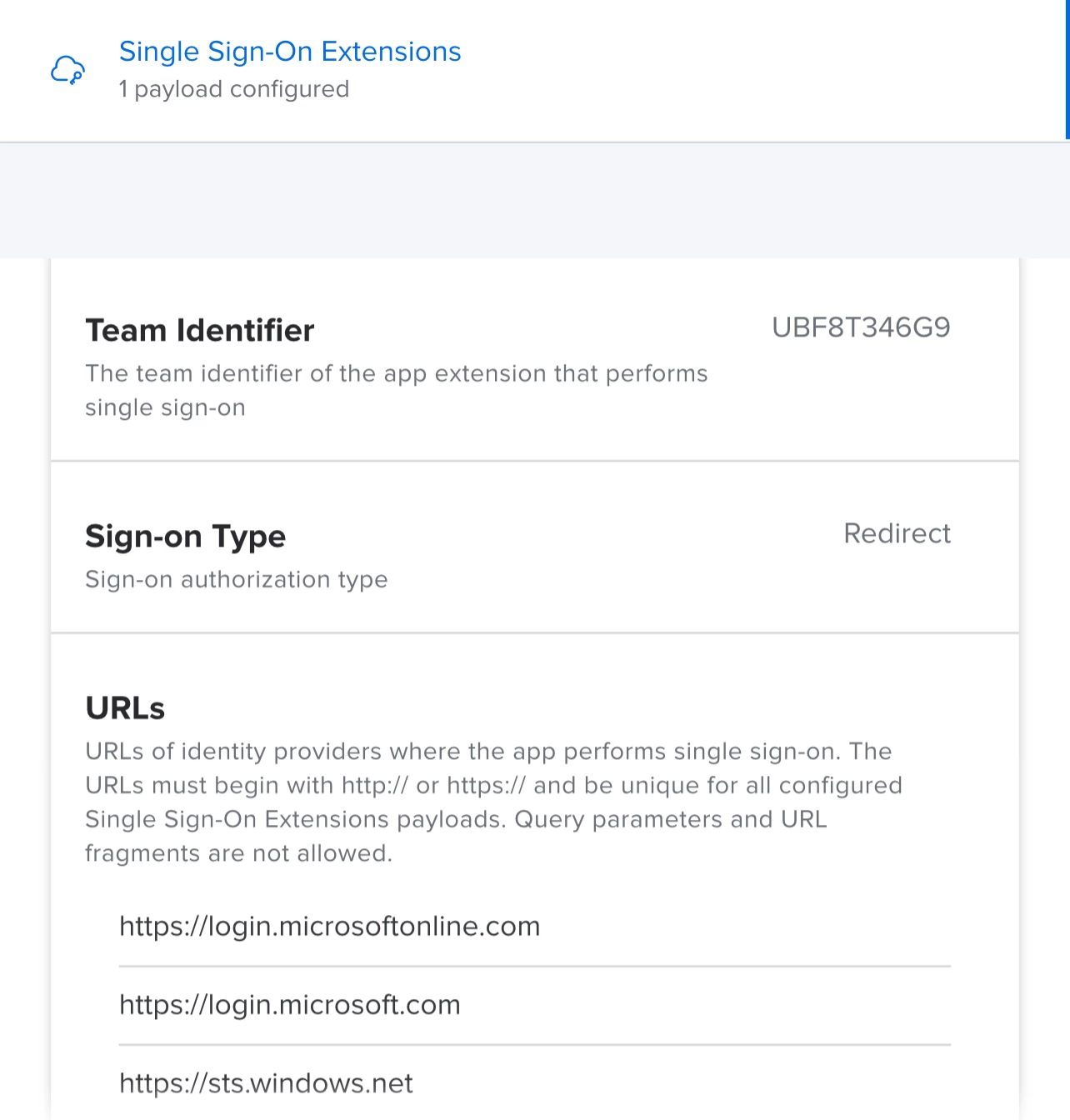

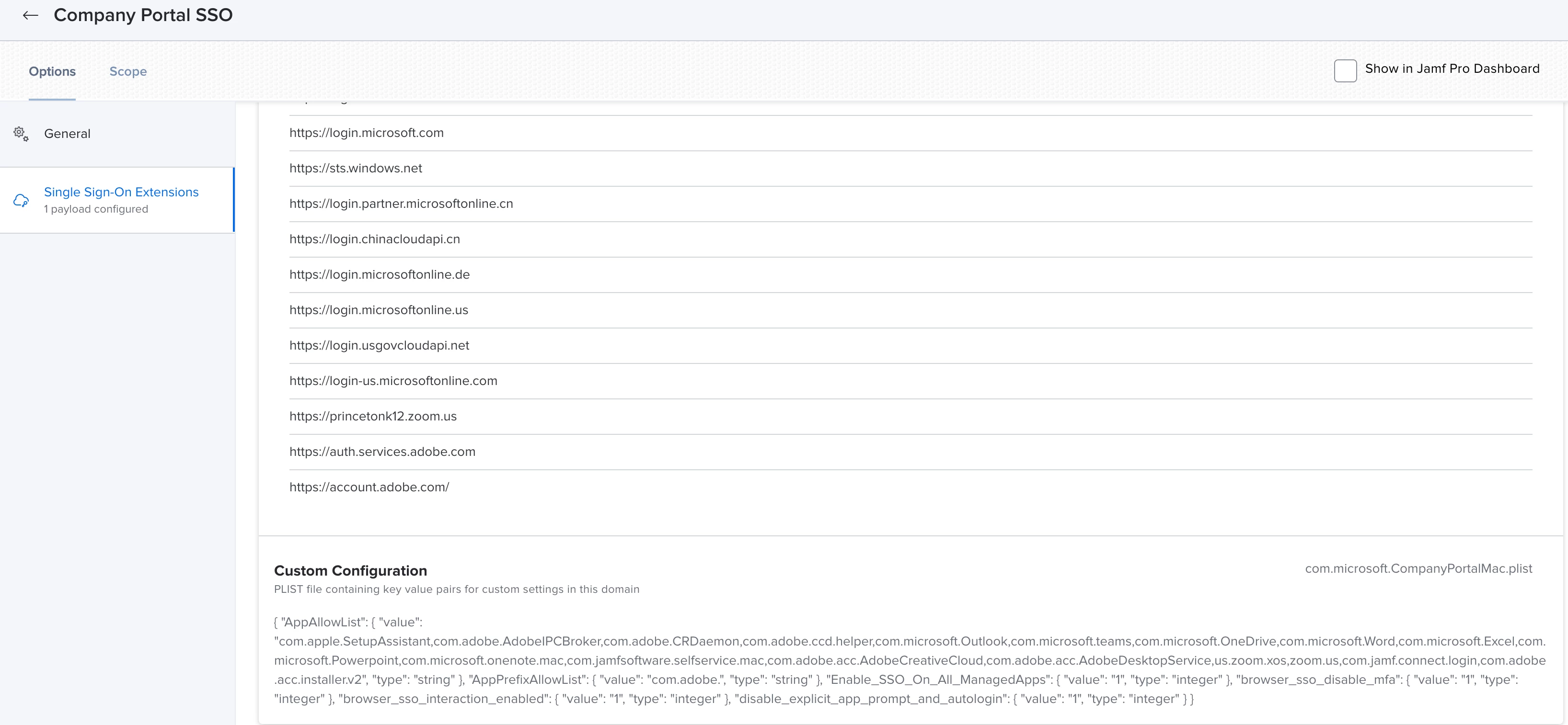

@djrory here is a screen shot of our sso config profile. It has a ton of extra stuff in the app approval settings that aren’t needed (you can lose all the Adobe stuff as it doesn’t work as well as the chrome and Firefox stuff.  But use redirect and not Kerberos as seen below.
  • Feb 15, 2022 4:25 AM UTC
Thanks Gabe that's really helpful.

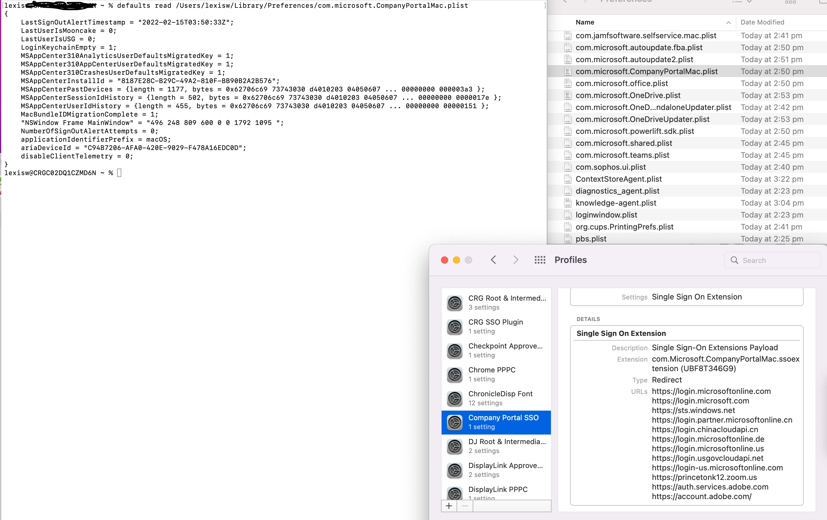

I've replicated pretty much everything above but I'm finding the actual PLIST file does not seem to take? Am I looking at the right plist?
You should just create it from scratch and set the keys with the “defaults” command, but before you upload it into the config profile you have to convert the file with this command
plutil -convert xml1 ~/Desktop/com.microsoft.CompanyPortalMac.plist
  • Feb 15, 2022 4:44 AM UTC
I did convert it, but I didn't create from scratch. I'll give that a go now. Cheers

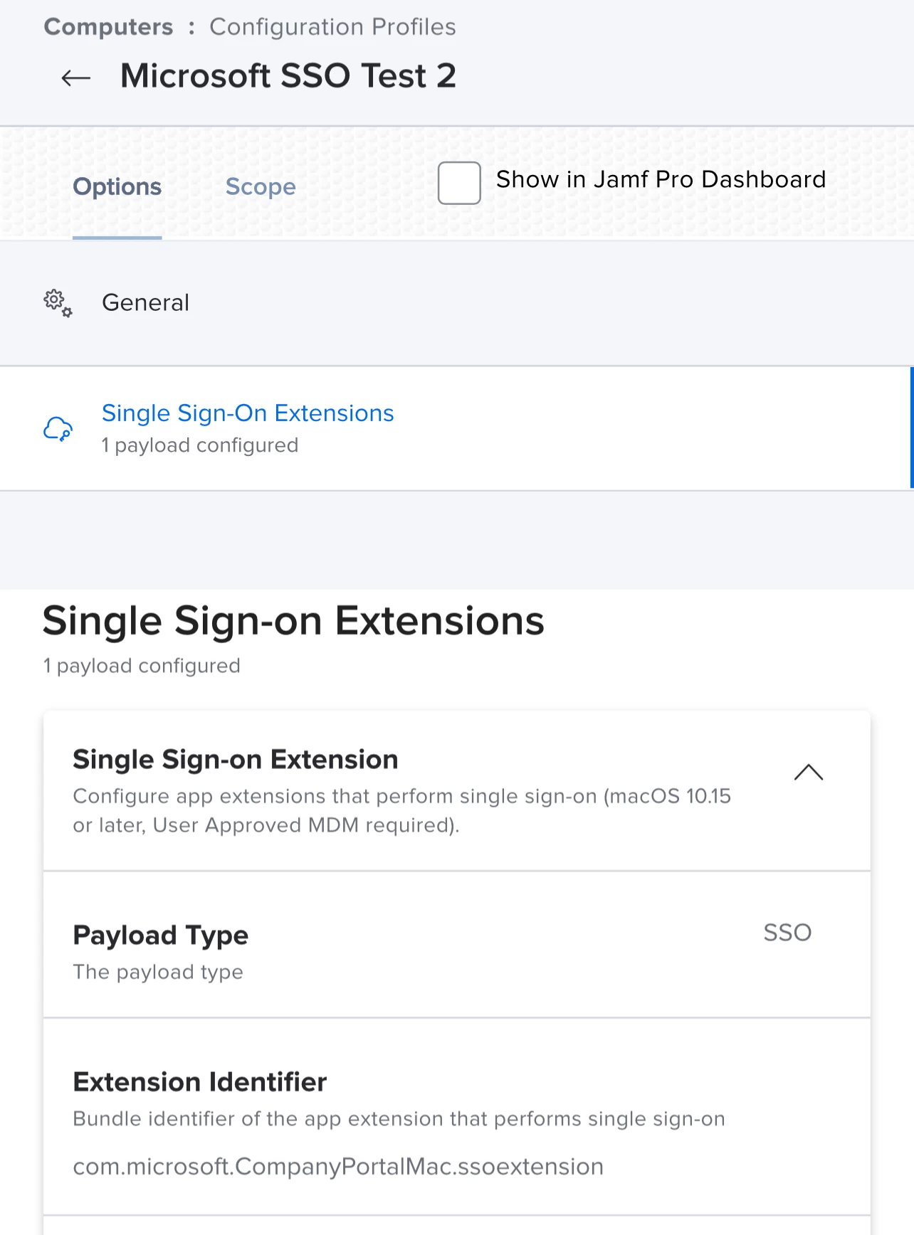

Hi ,
Sharing my configuration
Hey @vinu_thankachan
I have a similar configuration and wondering if you can post what you see on the macOS device? I'm unable to see the additional custom configuration nor does it work on our test devices.
