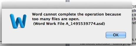

We are experiencing a suite of odd and frustrating errors with Office products on our Macs. It started off small and has soon spread throughout our school district. The some of the most common errors are:
With this error there were no other files open, or often only one or two files.

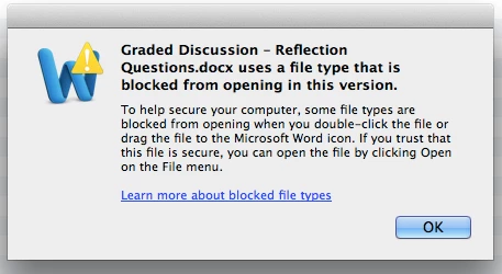

With this file, it had been used by multiple users prior to this. And as you can see from the name it is a simply a normal .docx

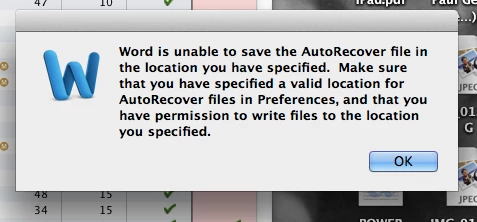

The AutoRecover problems happen quite a bit. The user has perfectly normal permissions and if the file is quit out of the user will be able to reopen it and use it for a period of time until this again occurs.

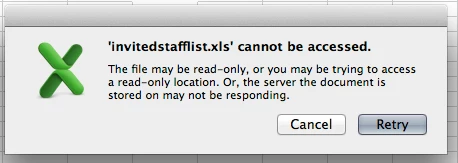

The files here are never read only and in fact exist in various locations (the users Desktop, Documents, Google Drive and other folders), all of which are available and are not read-only.
Also, at the time of this posting a system we were testing had the AutoRecovery error but had no files open at all during that time, just Word. It appears that the error was for a file that had been closed some 10 minutes earlier.
