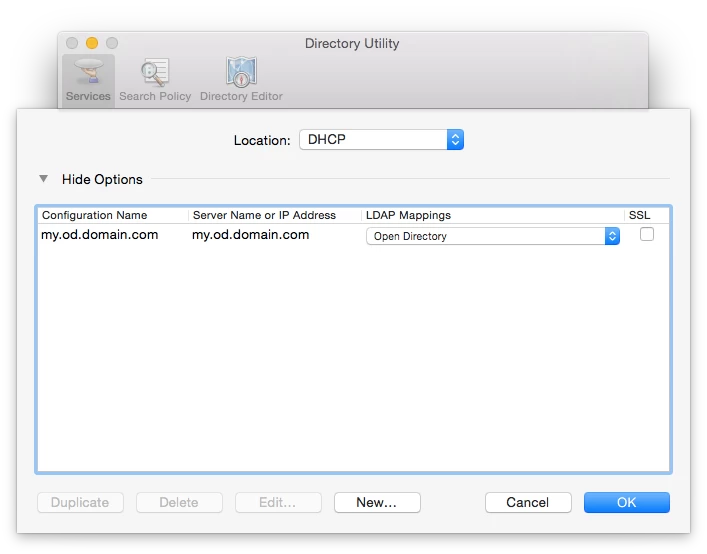

@lee.smith If I'm reading it right and you want to remove the OD connection from the Macs before joining the new AD domain, you can accomplish it with a one line command added to a policy in Casper:
dsconfigldap -r name.of.od
So if I had an OD connection on the clients like this:
I would do the following:
  1. Create a policy in Casper set to run once per computer at startup
  2. In the "Execute Command" field of the "Files and Processes" section, enter the command dsconfigldap -r my.od.domain.com
  3. Scope to the computers you want to run it on and restart them
If the computers are already on and restarting would be cumbersome, set it on the recurring check-in trigger instead.
Then you can use a normal AD bind in the JSS to get them hooked up to the new directory.
