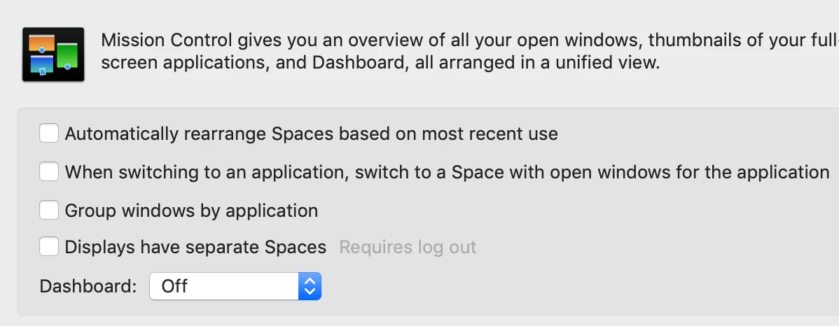

I need to disable "Automatically rearrange Spaces based on most recent use" in Mission Control for state assessment testing. Doesn't look like I can do this in PPPC Utility. How are you configuring this in your environment?

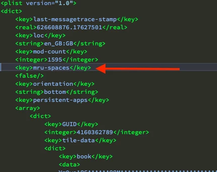

From this you can see that when you click that option you are referring to (mission control spaces), the currently logged in users dock plist file is being updated.
If we then look inside the file using BBEdit to see what is changing each time the mission control spaces option is clicked we see a setting near the top of the file called mru-spaces that keeps changing from true to false and back again each time the setting is changed.
You could create a customized dock plist with the setting turned off and add it to the 'custom apps & settings' payload in a configuration profile.

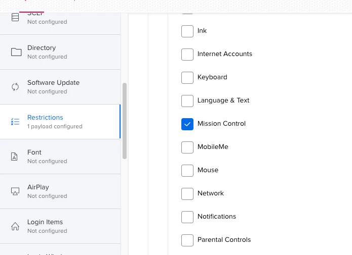

Once you've got your setting disabled (I don't know if you can lock it) you can hide the mission control icon from appearing in System Preferences by using the 'Restrictions' payload in a Jamf configuration profile to disable the mission control icon from being clickable.
