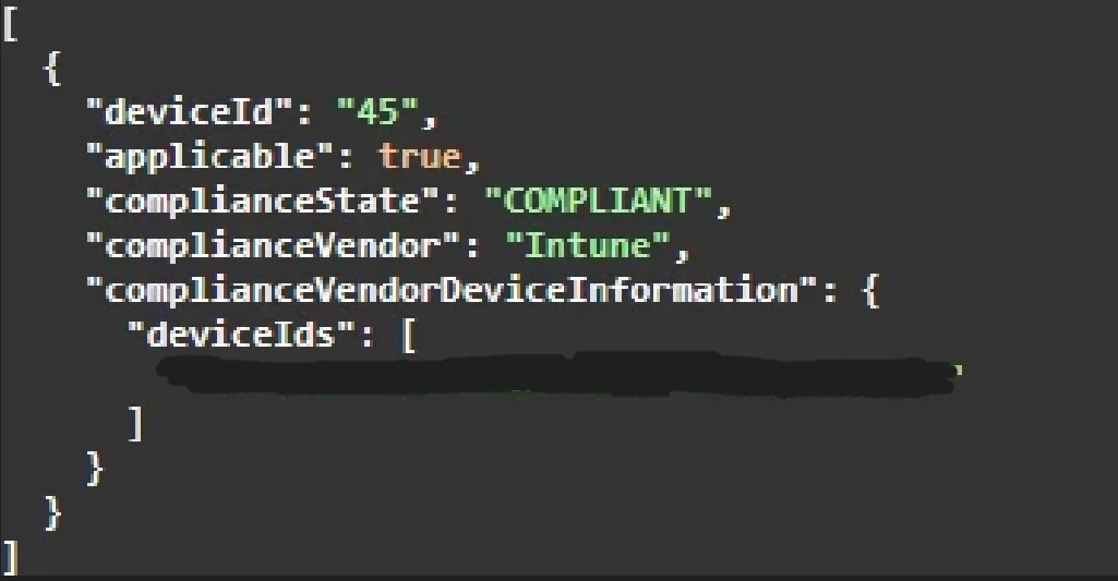

drewcymek
  • Aug 12, 2025 5:14 PM UTC
I’m not positive I fully understand what your goal is. If you are using Jamf device compliance integrated with a vendor. Compliance is set by Jamf alone. Jamf passes the compliance to the vendor - in this case Intune. The only thing Intune really does is receive compliance information and pass it along to CA policies.
The path way I provided is from Jamf’s API. This is the return from a device search.
