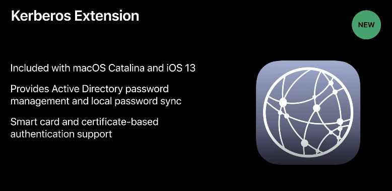

@Over9000 I have them reset their passwords through NoMAD. If they do end up changing their passwords outside of NoMAD, like though OWA or in AD, NoMAD notifies them that their password was changed elsewhere. I don't have them change their password through System Preferences because NoMAD doesn't pick up on that change. From what I've heard with NoMAD is the open-source one will still be developed along side Jamf Connect. The Jamf Connect version is the NoMAD Pro previously and doesn't connect to an on-prem AD. It's primarily for cloud directory services, like Azure AD and Okta.
With that said though, Catalina is bringing in a new password extension based on Enterprise Connect. So I'm looking forward to see how that'll work in my environment.

  • June 14, 2019
@donmontalvo it's in one of the WWDC videos that available to the public. It was the "What's new with managing apple devices." Starts around 35 minutes talking about the new SSO pieces that includes the new password extension.

  • June 14, 2019
Link to video where Apple discusses this.
