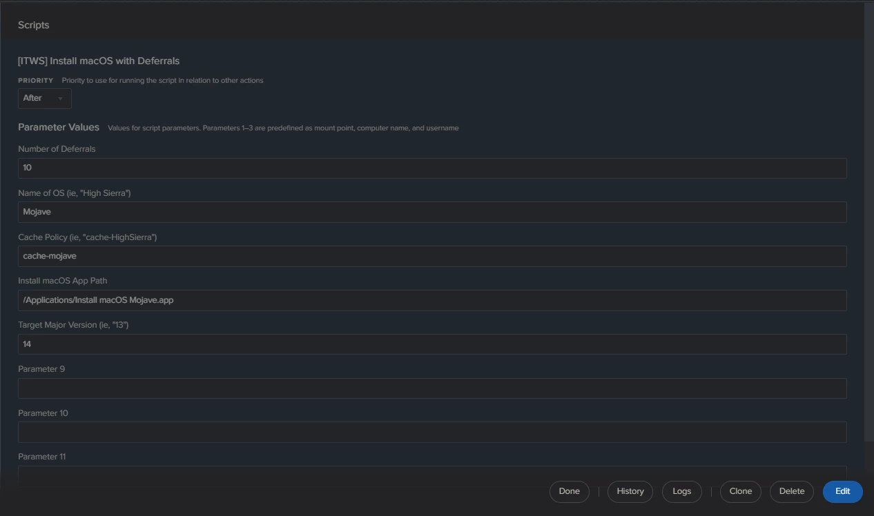

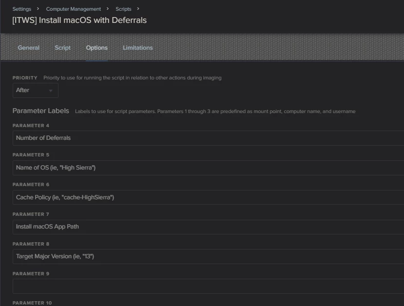

@calvins Can you share a screenshot of how your policy is setup?
  • November 14, 2018
Just the script in this policy, no restart options or anything else:
And the parameter labels:

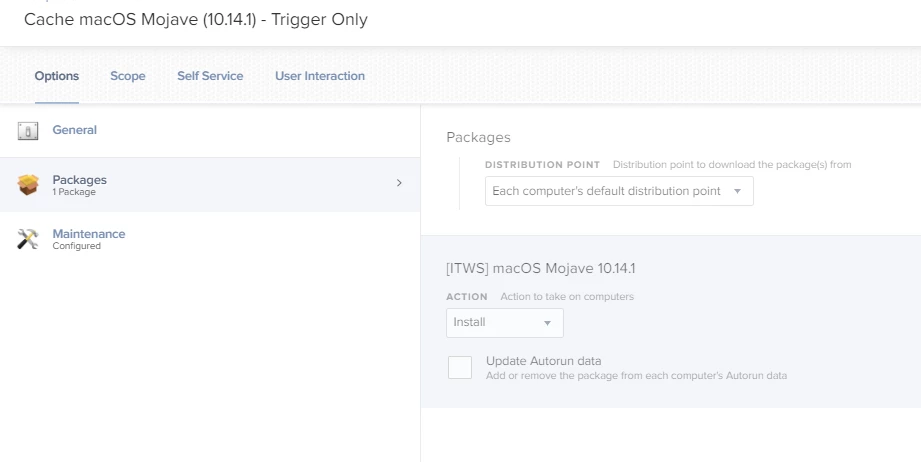

And the "cache policy" mentioned is just a PKG installer for dropping the installer into the usual spot in /Applications, nothing special.

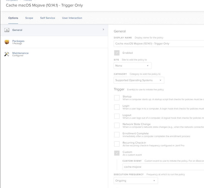

@calvins Can you share screenshot of the triggers? I am wondering how the machine will know when the OS is fully cashed and now proceed to install.
Thanks.
  • April 12, 2019
@aaelic24 The installer script handles detecting the installer, I thought it was a bit easier instead of using smart groups and criteria based on the machine inventory, that's the "check_installer()" bit in the script above.
The installer itself is just a drag/drop of the installer. Just like this article except putting it into /Applications instead of /Users/Shared: https://www.jamf.com/blog/streamlining-your-macos-upgrade-process/

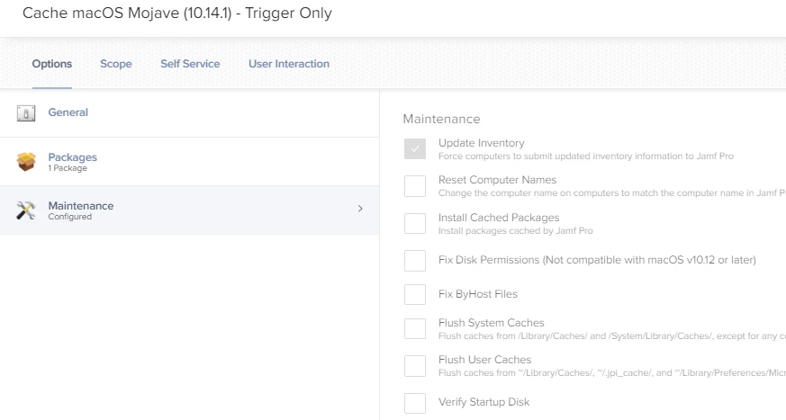

This is the cache policy that goes with it:
