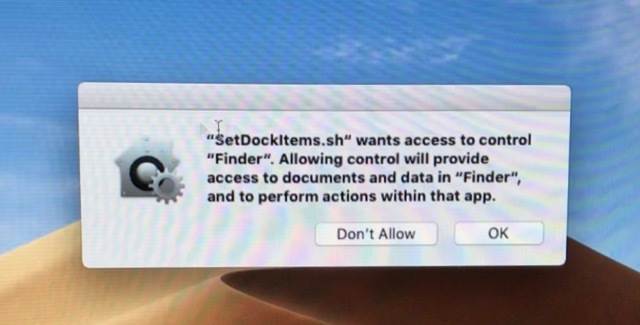

In our environment we use a custom Guest account to be used in the break room. We have a script that runs on startup that sets the dock the way we need it for that environment (SetDockItems.sh). Mojave's user approval requirement means that any time the machine is rebooted or the user logs in, they need to allow the script that sets the dock to run. Does anyone know of any workaround for this so we don't have to rely on user input?
Thanks!

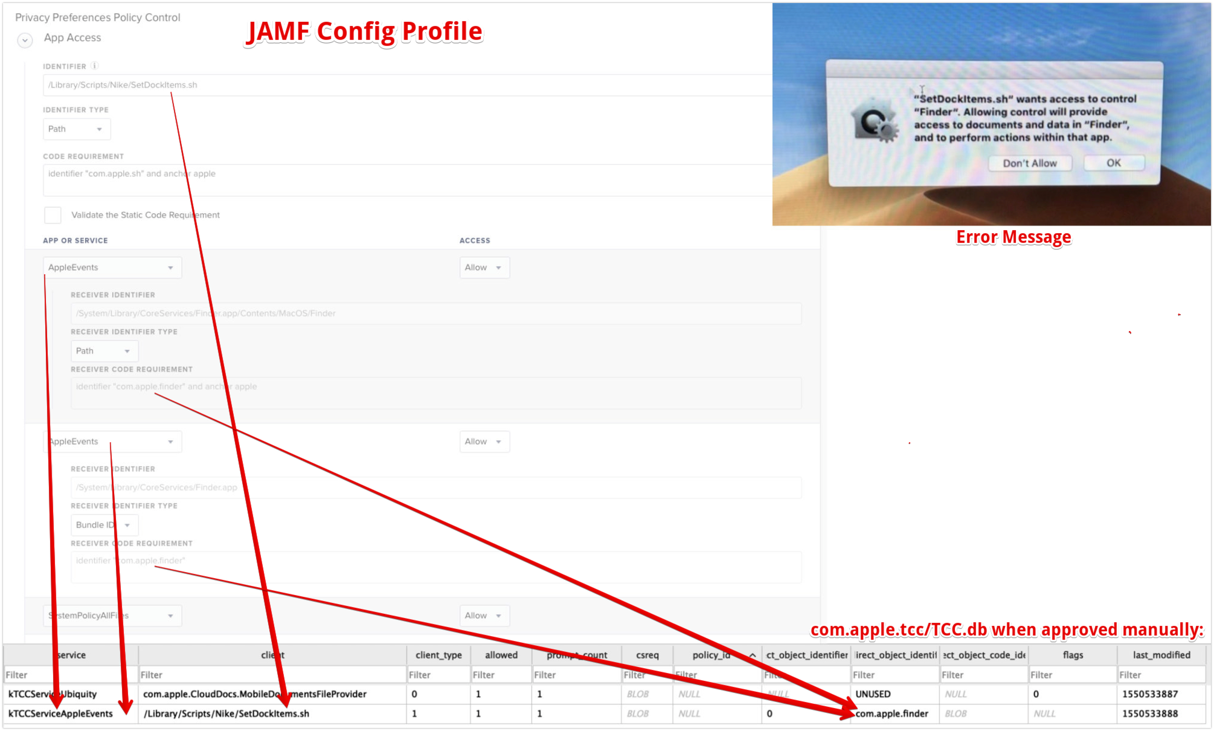

Welp, this is still an utter mystery to me. I've done a shotgun whitelist approach to no avail including all variants of the script itself, sh, bash, osascript, etc. I took a look at the com.apple.TCC/tcc.db database before and after clicking the approval button manually, and by all accounts the config profile I've created in JAMF SHOULD allow this to work. Attaching a screenshot to show proof that what I have set up in the JAMF config should match the settings that are in that database when approved manually. I'll update here if I discover anything new.

Yup! Code-signed the script, created a config profile to whitelist the newly-signed script, and all is well now. Thanks everyone!
