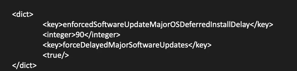

On macOS Big Sur you can use the new "com.apple.applicationaccess" preference keys to delaying major OS updates for 90 days: set "forceDelayedMajorSoftwareUpdates" to true, set "enforcedSoftwareUpdateMajorOSDeferredInstallDelay" to 90. This works Specifically for 11.3 and onwards clients
https://developer.apple.com/documentation/devicemanagement/restrictions?changes=latest_minor
Thank you. I'm pretty new to this so can you tell me where this is added in Jamf School?

Same here, except set to 90 days. Looking at what vinu posted earlier, software updates must be organized in different categories with different settings. Meaning "major updates" are not managed with that setting.

And I believe the preference keys vinu shared is for adding to a custom .plist to upload as a configuration profile. As far as I can tell, Jamf Pro has the feature built into their configuration profile payload while Jamf School does not.
