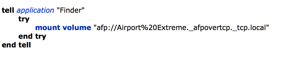

Hi,
I wrote this simple script to mount out network drives. I got it to allow the user to mount to the finder but, then they have to drag their folder over to the desktop. Is there any way I can have the script check who is logged in and then mount their folder to their desktop?
Thanks, Jared
