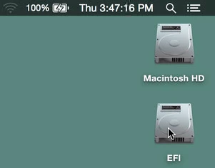

This is the output from a Mac that has the EFI partition automatically mounted on the desktop. I ran the command on a Mac that just happens to not have the EFI partition mounted at the moment and it is identical with the exception of the UUID

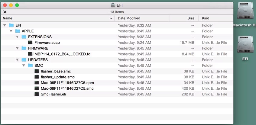

Here's a screen shot of the contents of the EFI partition on this particular Mac. The exact contents vary from computer to computer. Some will have all the files listed here, others may have just the FIRMWARE folder with something in it, others may only have an EXTENSIONS folder. etc.
For some brand new machines when I took them out of the box, I went ahead and ran software update on them BEFORE imaging to make sure that any and all firmware updates were applied AND VERIFIED. Some still end up with the EFI partition mounting with various contents. Just for the hell of it, I downloaded the firmware updates from Apple's website and applying them manually. Some updates said they weren't needed because it was already updated. One update told me that I needed to be running OSX 10.9.5 to install it. Regardless, According to System Profiler, all updates are applied and Software Update finds no more to get.
About the content of the EFI partition I discovered that this is usually the content:
-On each EFI hardware there should be an EFI partition (required by EFI specs)
-Sizes are between 209 and 300+ MB on newer macs.
-Each vendor is allowed to use it as it likes.
-PC vendors typically store some utilities on it, Apple seems to use it (temporarily) for firmware and smc updates, and usage varies with different hardware.
-After a clean install the EFI partition is usually empty.
-OS updates like 10.10.2 (thunderstrike), 10.10.4 and probably others too leave firmware updates behind on applicable Macs (like your example), the same OS will not put anything in EFI on an iMac 2007. See Allister Banks blog post on afp548
-on 2013+ Mac's with bootcamp and windows8 or 10, Windows will use UEFI boot, and there will be a /EFI/Boot and /EFI/Microsoft folder with many files.

So why would the EFI partition be populated with items if I've already applied all thefirmware updates to the Macs? Imaging and re-imaging and re-imaging again doesn't always remedy the problem. Sometimes troublesome Macs will stabilize after 5 or 6 re-imaging sessions. When I use Composer to create the image, is it somehow also grabbing the EFI partition of the "master mac" that I created the image on?
@AVmcclint: It is only Apple who can answer the 'why' questions (:-), but to me it looks like leftovers from firmware updates. (which could/should be removed after applying the updates imho)
In the case of Bootcamp with UEFI boot the files are used...
Most imaging tools I know do NOT capture EFI partitions, and I guess Composer does not too (since the content is not required by Mac's, and as we found out the content varies by model this makes sense)
I have not checked if composer grabs the EFI however.

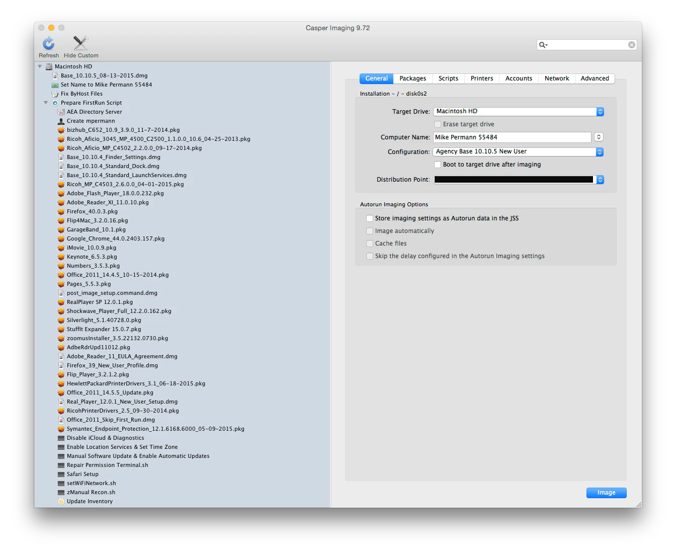

@AVmcclint do you mind posting a sanitized screen shot of your Casper Imaging workflow so we can take a look at what is being done?
@AVmcclint what is the unmount_recovery_part.sh doing? If you are using an AutoDMG created OS, which I am not certain that is what you are doing, there is no reason to do anything with the recovery partition. If you aren't using an AutoDMG created OS, would you mind posting a sanitized version of that script so we can take a look at it? Are you doing any custom partitioning that you aren't showing in the screen shot? You can click on Show Custom and click the advanced tab to check that out. Also, have you tried using the latest version of Casper Imaging (9.73) with your existing workflow. I believe the version of Casper Imaging doesn't necessarily have to match the JSS version. I know they used to say it did, but I think some things have changed in that regards.
The unmount_recovery_part.sh is a script that my predecessor put in place and it didn't seem to cause problems under 10.9 so I left it alone. The script in full is:
/usr/sbin/diskutil unmount /dev/disk0s3
/usr/sbin/asr adjust -target /dev/disk0s3 -settype Apple_Boot
I'll take that out of the flow and see if that helps anything.
Not doing any custom partitioning. I've tried using the newer 9.7x Casper tools with our older JSS but it throws up an error telling me I can't use it because the versions are different. I held off on updating to 9.7x when I read all the problems that a lot of people were having. I'm hoping 9.8x fixes those problems so I can update soon.

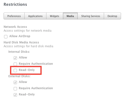

I think maybe, perhaps, there is a chance I may have found the underlying cause of the kernel panics. We have a Config Profile that limits the read/write to USB drives. One of the settings for Internal Disks was checked for Allow and Read-Only. I'm not sure why that was selected since all our macs are either laptops or iMacs - all with single drives and no extra drives installed.
One day recently I was going over every setting in our config profiles to see if I could clean up or optimize things and I saw that setting and I decided to clone that Profile and uncheck the box for Read-Only on the internal drives. I pushed it out to a handful of Macs. I rebooted a few Macs that were having the problem and I discovered that the EFI partition stopped mounting at login. I rebooted the computers several times just to make sure... the EFI partition still wasn't mounting! I went back to the JSS and removed that fixed profile from these Macs and re-pushed the active profile with the setting enabled and the EFI partition returned! I rebooted several machines a couple dozen times to make sure and it was mounted 90% of the time. I removed the Profile and re-pushed the fixed profile to those same machines and EFI NEVER returned.
I unchecked the Read-Only box on the Profile that all the Macs get and one by one as the Macs rebooted, the EFI partition disappeared from desktops. Unfortunately I think the damage was done to a lot of these computers because a few continued to kernel panic, so I fixed them according to the steps described above. For Macs I've imaged since using this corrected Config Profile, they have never once displayed the EFI partition nor have they kernel panicked. I'm keeping my finders crossed.
