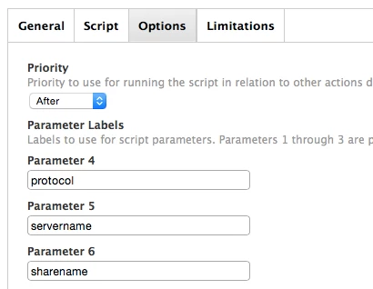

You add the script and set the parameter labels as:

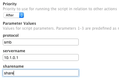

Once thats in place you can re-use the script in a policy, setting the relevant options:
Hope this helps.

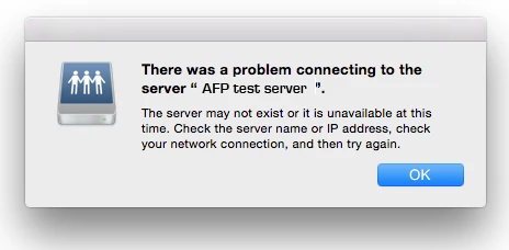

Hello everyone, despite the not so encouraging comments and suggested alternative routes, I am testing config profiles to manage network volumes with a "login items" payload.
I can limit the profile (applied at user level) to a specific Active Directory usergroup and its network volumes. This all seems to work fine, except when the computer if off network (e.g.: laptop)
When there's no network available, being the profile still there, an error message appears in the Finder, as the server is obviously not reachable
Would you think there's a workaround for this? Many thanks for your help!

I don't think the config profile approach is that flexible unfortunately. It just adds the share to the login items and doesn't do any checking whether the Mac is on or off the network.
A scripted approach with a policy would let you restrict it to network segments to avoid the error.
