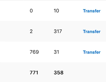

In Apple School Manager -> Apps and Books you select the app on the left and then transfer on the far right.
If you don't have that option then I would suspect that either your account does not have the permissions needed or the location is not setup.
  • April 3, 2019
I believe i have the permissions i would need, i can double check on that, but how would i add more locations. I suspect that is the issue since i only have one option for locations in the locations drop down menu, and the transfer option isn't there.
Thank you for the screenshot, i at least know what is missing!
