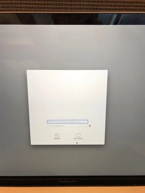

Hi folks, we had used Centrify to manage our MACs for quite sometime and recently had switched to JAMF Pro along with NoMaD and NoLoad(Password sync) to manage our macbooks going forward. One of the main reasons for switching was because Centrify would often disconnect from the Domain Controller and our Engineers would stay locked out of their Macbooks & could not change passwords.
Albeit, we had a rough onboarding and things were just not as smooth as we thought and there are a couple of issues still preventing us from rolling this out to our organization.
We had a very stubborn,quirky issue where after push out NoMad/NoLoad and their .plists and settings we have found upon reboot will not allow any user in except the administrator. Instead the intended user will get an infinite login loop and NoLoAD screen clears the username/password fields.
Here are our plists that are pushed out to /Library/ManagePreferences Folders.
