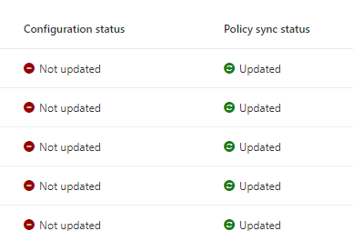

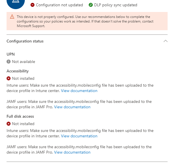

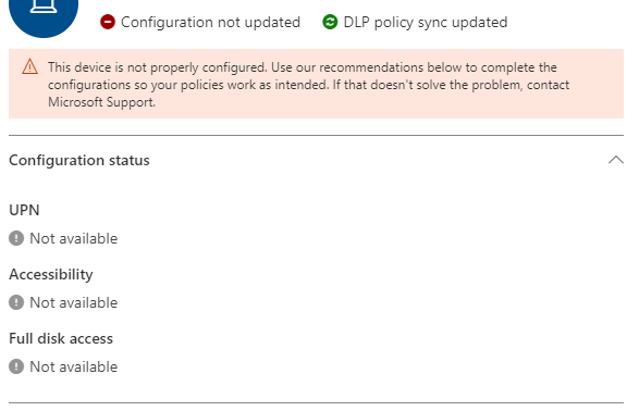

Here is an example of the details in Device Onboarding  in Microsoft Purview with the error messages before and the more informative messages after I have created the configuration profiles in JAMF from the above guide:
View under Device Onboarding:
Before the configuration profiles were updated:
After the configuration profile was updated:
In the documentation that I linked to near the top, there is a "Before You Begin section which mentions this (formatting mine for clarity):
We are managed through JAMF Pro, but we don't use JAMF Connect and they don't seem to have a UPN as shown in the screen shots above. I suspect this is a big part of the problem - but not sure how to fix it. Or am I incorrect and this is a red herring to some other problem in the Configuration Policy/settings/PPPC in JAMF Pro? Maybe both?

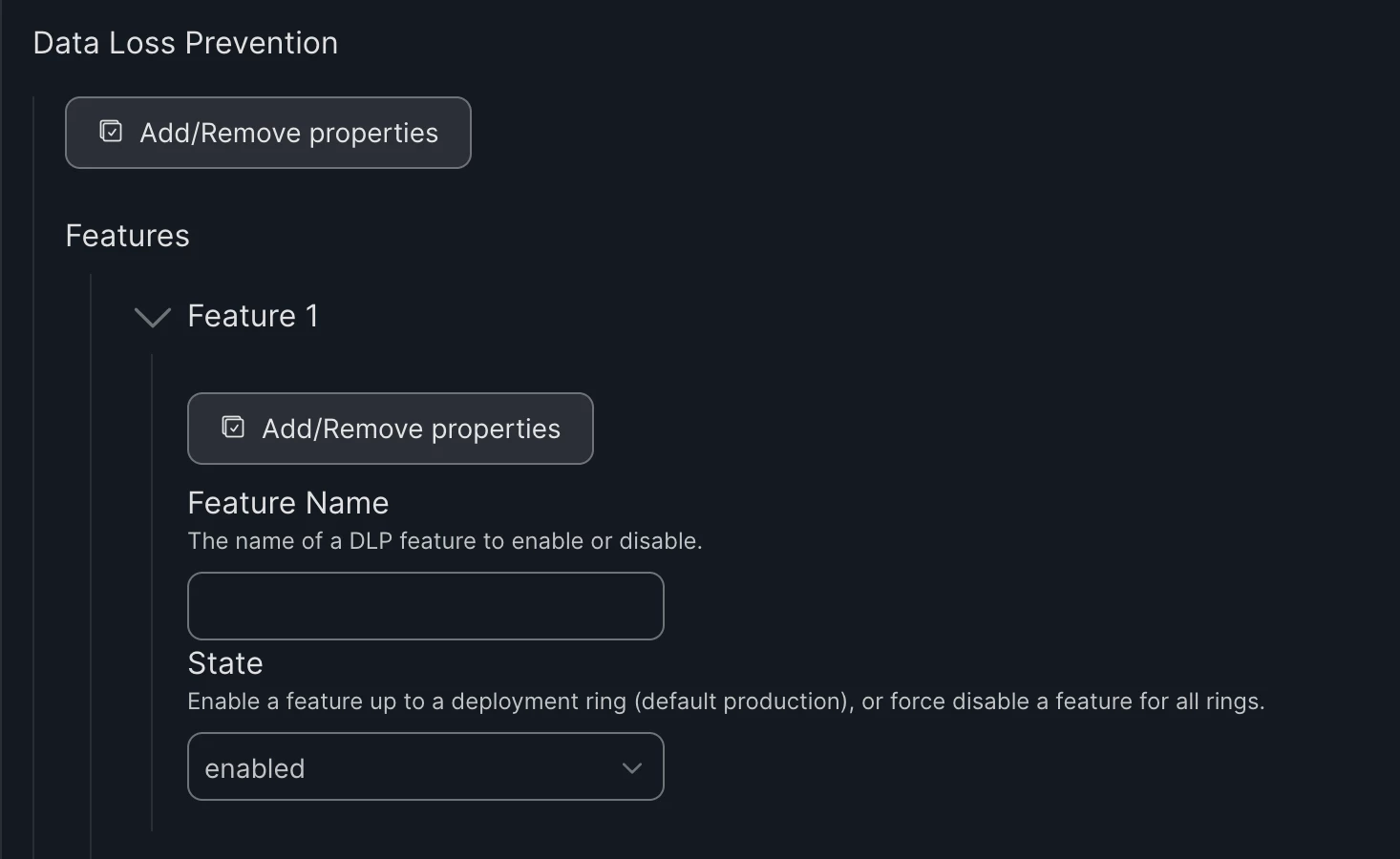

Hi ​@VintageMacGuy I was able to get DLP via Purview deployed through Defender and we have a existing Defender deployment. I would agree the instruction from Microsoft on not very clear for those in our situation.
There is a setting within the Defender Default settings profile to turn on Data Loss Prevention. To enable this, you have to add the Feature setting and then once added, you can add the DLP setting and then set to enable.
Next you need two PPPC payloads, one for Full Disk access for com.microsoft.dlp.daemon and one for Accessibility access for com.microsoft.dlp.daemon.
The computer may then also require a reboot but this should then enable DLP.

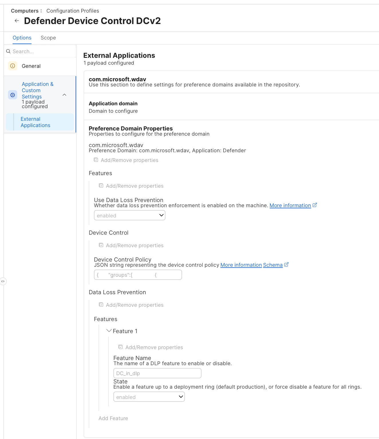

​@rasik  What is the Feature Name to enable DLP? Screenshot below is the Defender configuration settings within Jamf Pro. I currently have Defender rolled out in my org and Security is now requesting to enable DLP.
  • Apr 24, 2026 2:14 PM UTC
The Microsoft documentation you’re following is only showing how to onboard Defener onto a Mac.  The documentation for Device Control and DLP are here. The big thing to look out for, is the json file containing the rules goes into the Device Control policy field.
