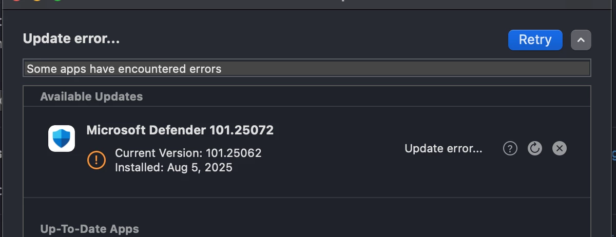

As some of you may know MS messed up the the last version of Defender and it does not let the install go forward because tamper protection is set to block. Usually it sets it to enable the install and then back on. Does anyone have an easy way to do this in Jamf. I am not great with scripting and the only way I see to do it is via a few policies.

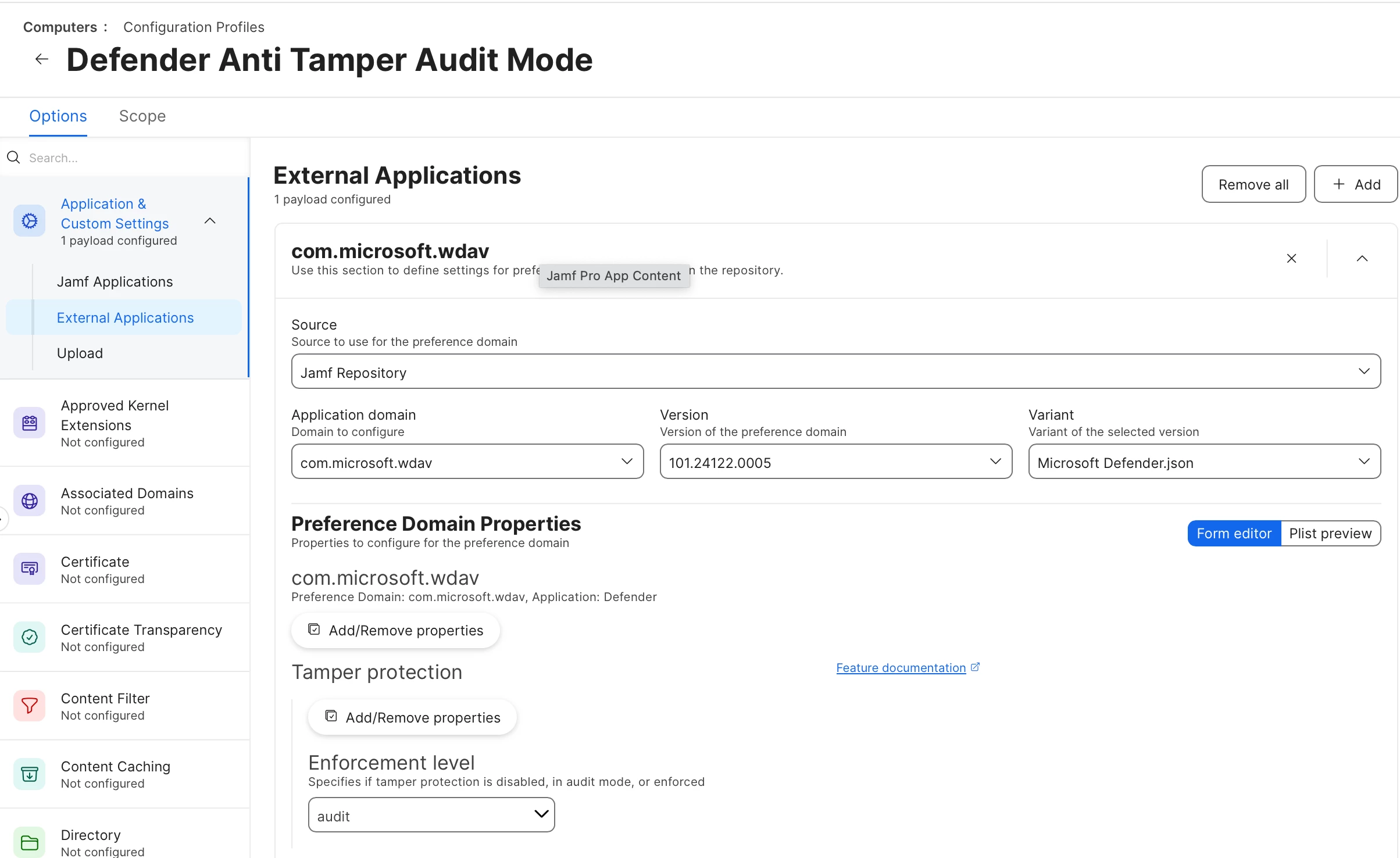

You can temporarily set anti tamper mode to audit.  I made a smart group where the Patch Management Title for Defener was not the latest and assigned this profile to it.  Once machines update, the profile is no longer scoped and anti tamper goes back to the default block setting.

I knew coming here would find what i needed. I also noticed that MS defender was failing auto updates on my clients and need to implement a fix also
