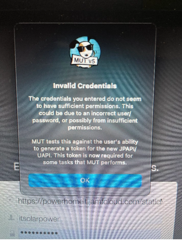

Hello I am getting an error message below when attempting to use mutv5 to add devices to a static group.
I can login with admin credentials when I just login to "powerhomeit" . However when I attempt to login to the path where the static group is Im getting an error stating that I dont have correct permissions. I am full admin with full access.
First issue resolved. Leaving the solution to help others if needed.
Root cause Was I was using the wrong template. To create static group you need to use the groups and prestages template. login with normal jamf cloud login, (company id not the full url, username and passwd).
I could then successfully login and setup which static group I wanted to populate.
