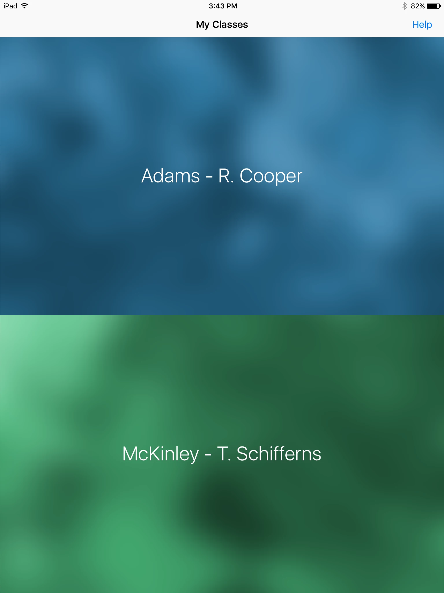

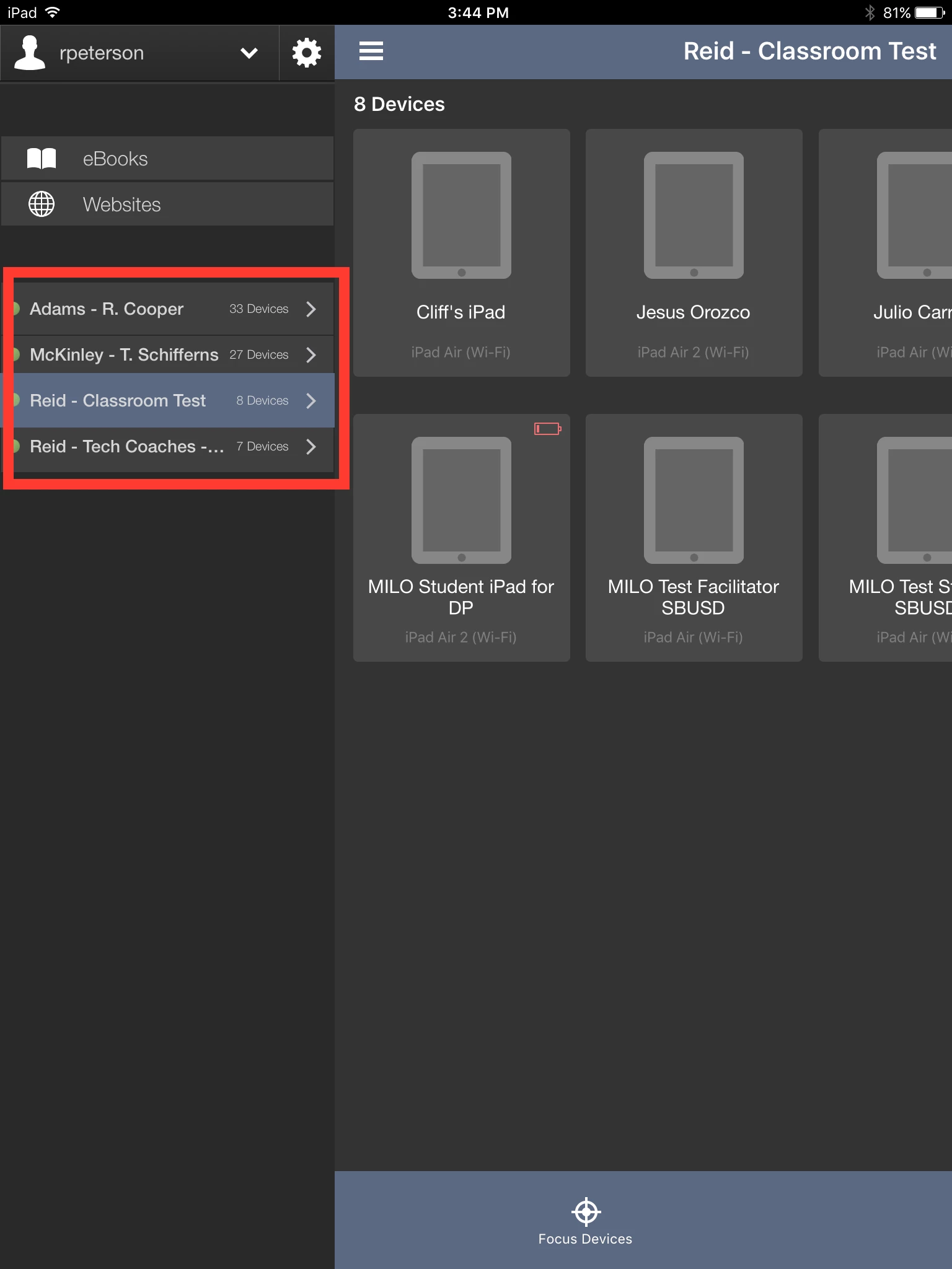

I recently created 2 classes in Casper Suite. These 2 new classes appear in my Casper Focus app but do not appear in the "My Classes" section of my Apple Classroom app. Knowing that the class was set up correctly because it shows in Casper Focus, does anyone have insight as to why the classes are not showing up in the Classroom app?

@St0rMl0rD the classes were created via user accounts. I didn't use any device groups for this trial.
@brad I created a new class that pulled 4 students from a class that was previously set up (successfully). I know the devices meet the software and hardware requirements for the classroom app. I'm now waiting to check to see if the education configuration profile updates. Will let you know when I see any changes.
