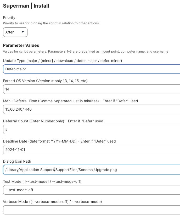

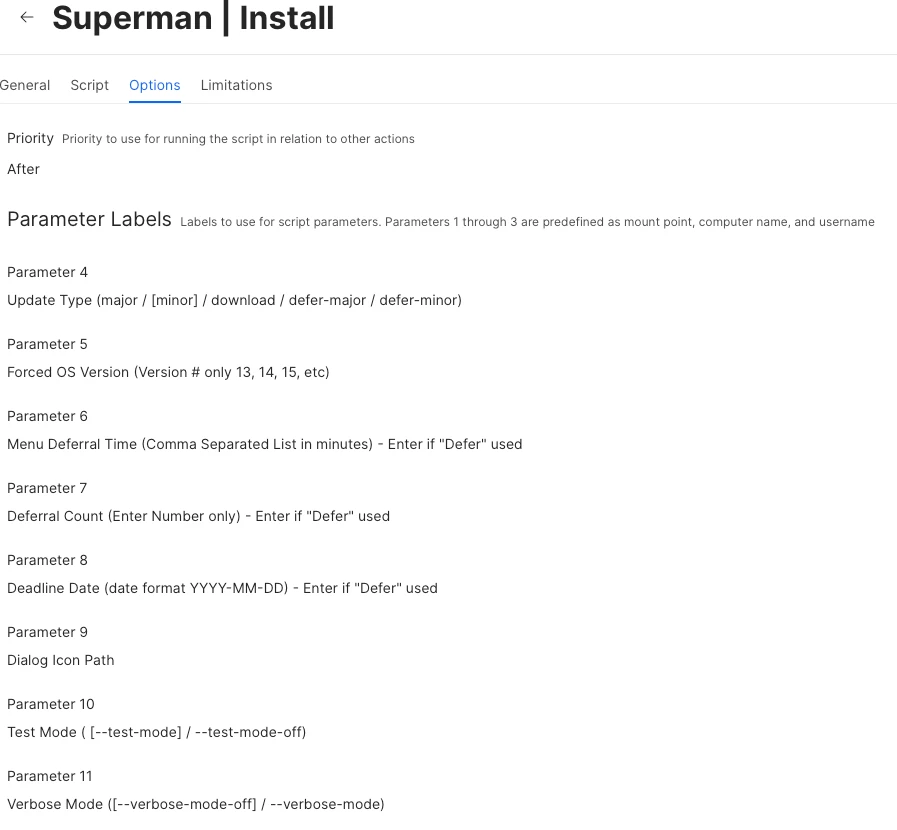

and the corresponding parameters screen that goes along with it:
and a sample with the parameters filled in:
