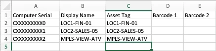

What you can do for the name is to use MUT, https://github.com/mike-levenick/mut/blob/main/README.md. The image below is an example of the filled template file.
Also, when I said automate in Excel is that you can add and/or replace the text for multiple cells at once.
You have to use MUT after the device is enrolled while the Inventory Preload can be setup prior to enrollment.
