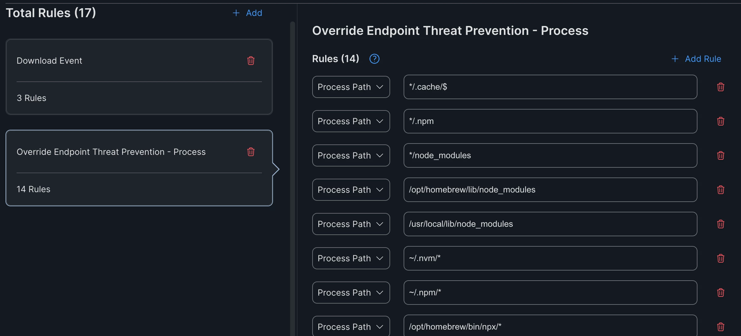

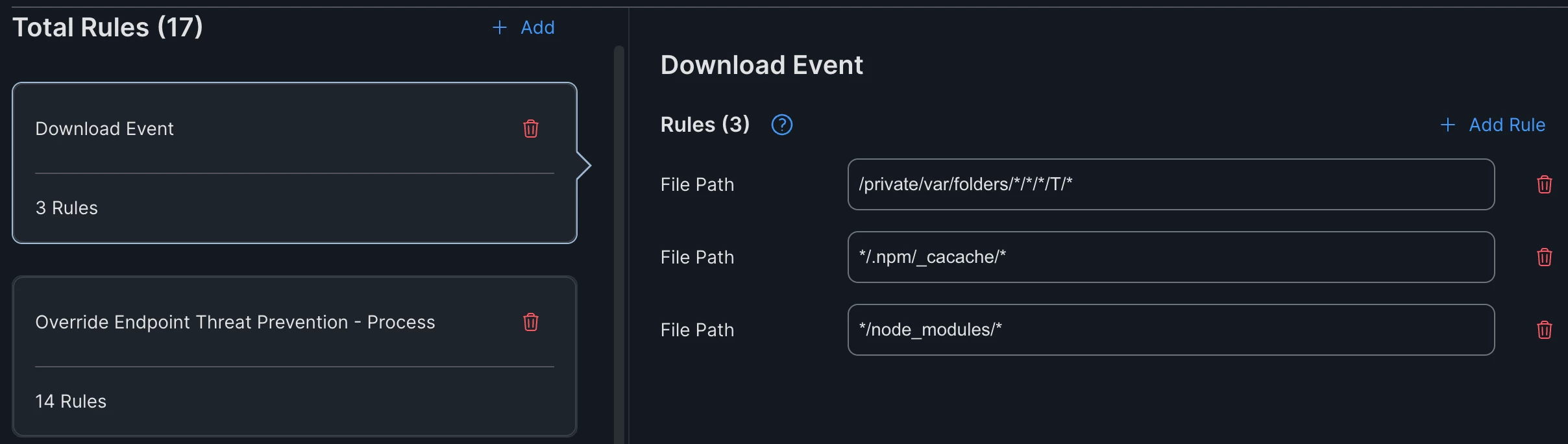

To try to fix this, I added the following exceptions:
  • Download Event exclusion
  • Override Endpoint Threat Prevention – Process exclusions
However, instead of improving performance, these exclusions seem to make the scan even slower.

Looking at your screenshots, you've configured "Download Event" and "Override Endpoint Threat Prevention - Process" exclusions. However, these exclusion types may not be the most effective for your use case:
  • Download Event exclusions only apply to files flagged with a quarantine attribute (typically browser downloads). npm packages don't get this flag, so these exclusions won't help.
  • Override Endpoint Threat Prevention - Process is for allowing specific processes that would otherwise be blocked by Threat Prevention - it doesn't reduce scanning overhead.
