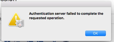

All of a sudden, I am having a very strange issue and cannot bind my Mac computers to my Active Directory. Windows machines bind perfectly fine.
I am getting the following error:
/Active Directory, Module: ActiveDirectory - krb5.dylib - set password using MS set password returned: 0 result_code 3
2017-05-15 14:03:55.372321 EDT - AID: 0x0000000000000000 - 74357.1515673, Node: /Active Directory, Module: ActiveDirectory - krb5_credential - Changing password failed for 'bpage-imac$@CORP.MYDOMAIN.COM' with error '' (3)
2017-05-15 14:03:55.372328 EDT - AID: 0x0000000000000000 - 74357.1515673, Node: /Active Directory, Module: ActiveDirectory - failed to change computer password deleting record - 'cn=bpage-imac,CN=Computers,DC=corp,DC=mydomain,DC=com'
It is driving me crazy. DNS looks fine. Time and date is set to the domian controller.
I have tried.. shortening the computer name
creating a record in AD first
using a different account to bind
using a different OU to add the machine to..
preferring one of my DC's over another.
Any ideas?

So, via the Mac Admins Slack channel, I found a fix.
I needed to create the record in AD first...but create it in a different OU than the standard Computers container. Once I create the record and bind to a different OU, in my case OU=Macs ... the machines started to bind just fine.
