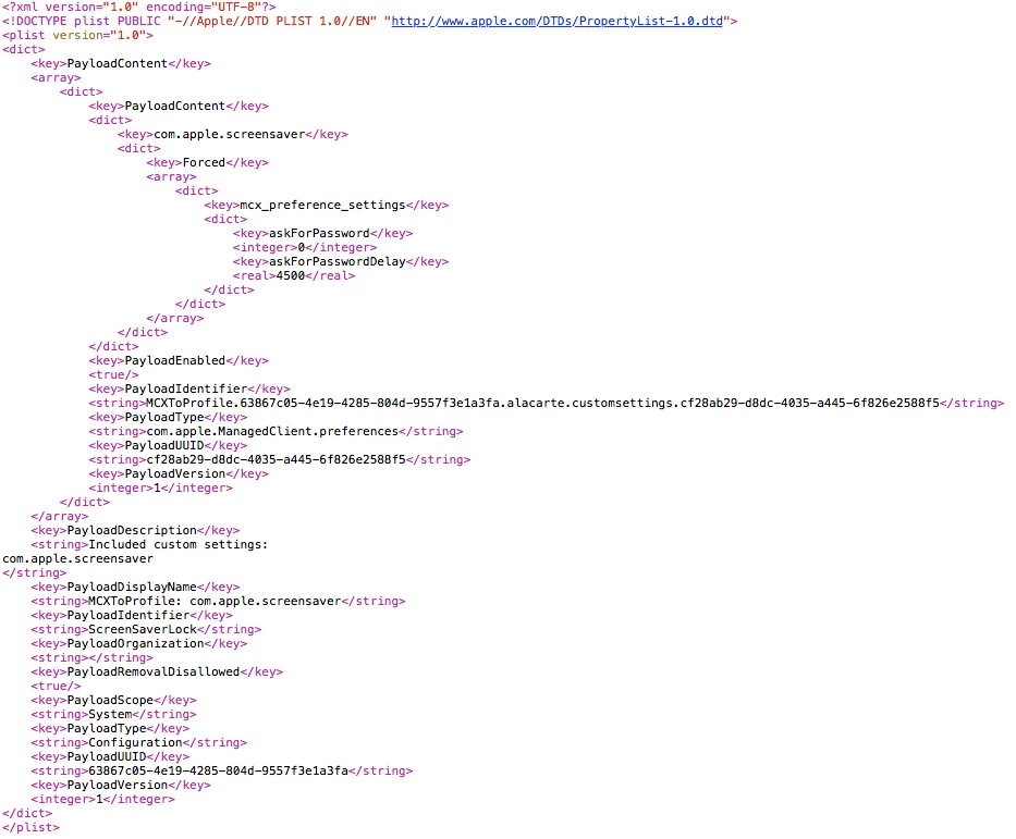

Could you post the config profile XML? There might be something in there that isn't set quite right.
One possibility would be to change the <key>Forced</key> to <key>Often</key>.
According to MCXtoProfile, Often isn't really supported on Yosemite. So if this is Yosemite, YMMV. But still worth a try.
Yeah, Tim calls out to not use the Often key with profiles on his github page, since the behavior isn't reliable. But you could try it I suppose. I'm not sure if the recommendation to not use it applies to everything.
No behavior involving this box has been reliable thus far so here we go....
The much appreciated second suggestion <key>Often</key> does nothing to the setting. The only thing that changes is that the setting is no longer greyed out.

@jomccann i think you might need to delete the "askForPasswordDelay" key from the plist.
