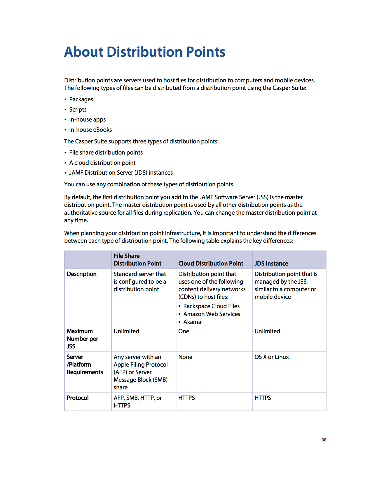

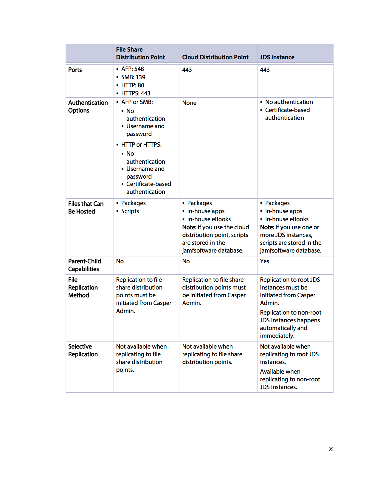

@mpermann Okay I switched to using the File Share Distribution Point (an afp share) and now imaging works for the force trackpad Macs, I am assuming from that that the base OS X is fine and something is wrong with Casper Imaging when using the JDS share.
