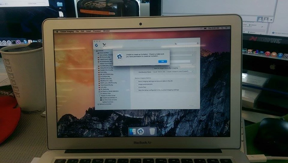

However... hahaha!! It's damn slow and it says something "Unable to create an invitation"
Dunno what the heck it is.

What is the exact error message you are seeing "Unable to create an invitation"? in which app, Finder?

Hi guys... it worked for me now but there's a new error message and I don't know what the heck it is.
Says something "Unable to create an invitation. Check to make sure you have permission to create an invitation"
Seems like a party invitation for me :)

Is there autorun data for the client you are imaging? What happens if you re-open Casper Imaging with the Option key held down?
There's no auto run data. Tried re-opening Casper Imaging but still the same issue. If I press the option key, it only ask to enter the JSS server details.
Any idea what's this error about? Thanks.
@mreaso Can you check the permissions of the account that you've logged into Casper Imaging with?
If you have an account with full permission can you try that?
Hi @bentoms ... my account has FULL permission. I've tried creating a new account as well with all permissions set. I'm stuck on this crap.
