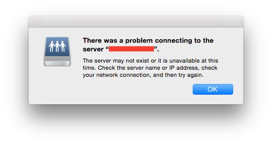

I'm having trouble mounting the SMB share so I can upload the NBI to the Netboot server when I click the "Upload Netboot Image" button. I keep getting the error message:
The server has a reserved IP address in our DHCP server, and a pointer record in our DNS server. So whether I use a DNS name or an IP, I'm able to connect to the webadmin page. I'm able to use "Connect to server" from the Finder to mount the AFP share, but it fails on SMB.
Any ideas?

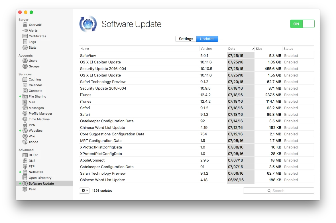

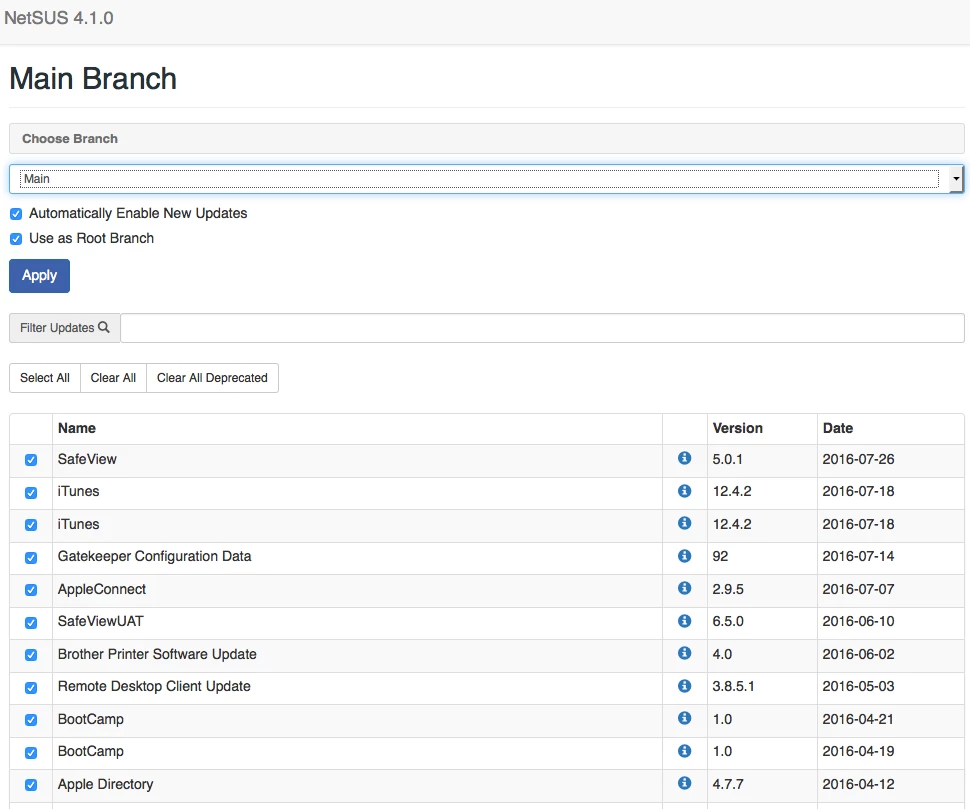

The new Netboot/SUS server I set up is not listing all the updates that my XServe is listing from Apple. When I tested the previous version of the software, it looked like it was getting everything. Any ideas how I can get these to match?
@itupshot
I'm getting the same error. Did you figure this out by any chance?
No, I haven't. It's still missing a lot of updates, including the more important ones, like the El Capitan 10.11.6, and the Yosemite security update. I did a manual sync, and it still didn't work.

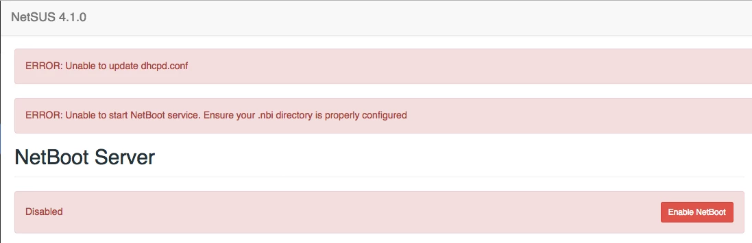

I just keep hitting roadblocks with this set up. Now, I'm getting this error message when I try to Enable NetBoot:
As I said in my previous post, everything seemed to work without issues when I tested v. 4.0 of this software. I have followed the instructions from the documentation on this current version, but I think there are some gaps.
I'm getting very discouraged.

I haven't been able to mount the share if I use the webadmin website link. If I use the Mac's Finder, and just put in the IP address and share, it'll mount.
