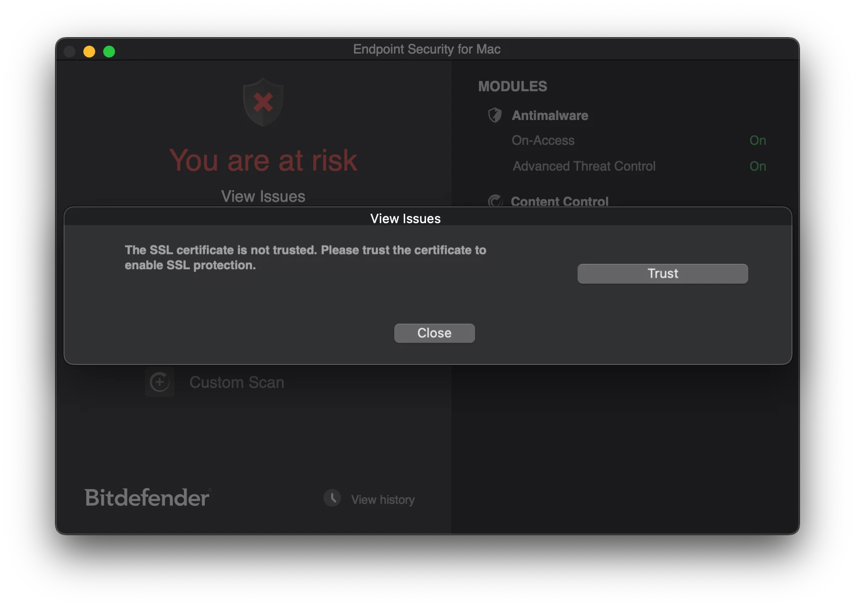

  • Dec 9, 2022 2:28 PM UTC
I've same issu with ssl certificat if we active the traffic scan ssl network... like this case https://macadmins.slack.com/archives/C0C4X3G3W/p1660243674574319
Any idea ?

@greatkemo
Thanks for sharing your script. I am still stuck with this Bitdefender SSL trusting issue. I have tried everything but no luck. I would like to try your script. Please help me with the script, for $4 I will set it to my Jamfpro URL and what should I set for $5?
Also, should I just attach this script alone in the policy or I should attach the package and the script together in the policy?
Thanks
Joy
