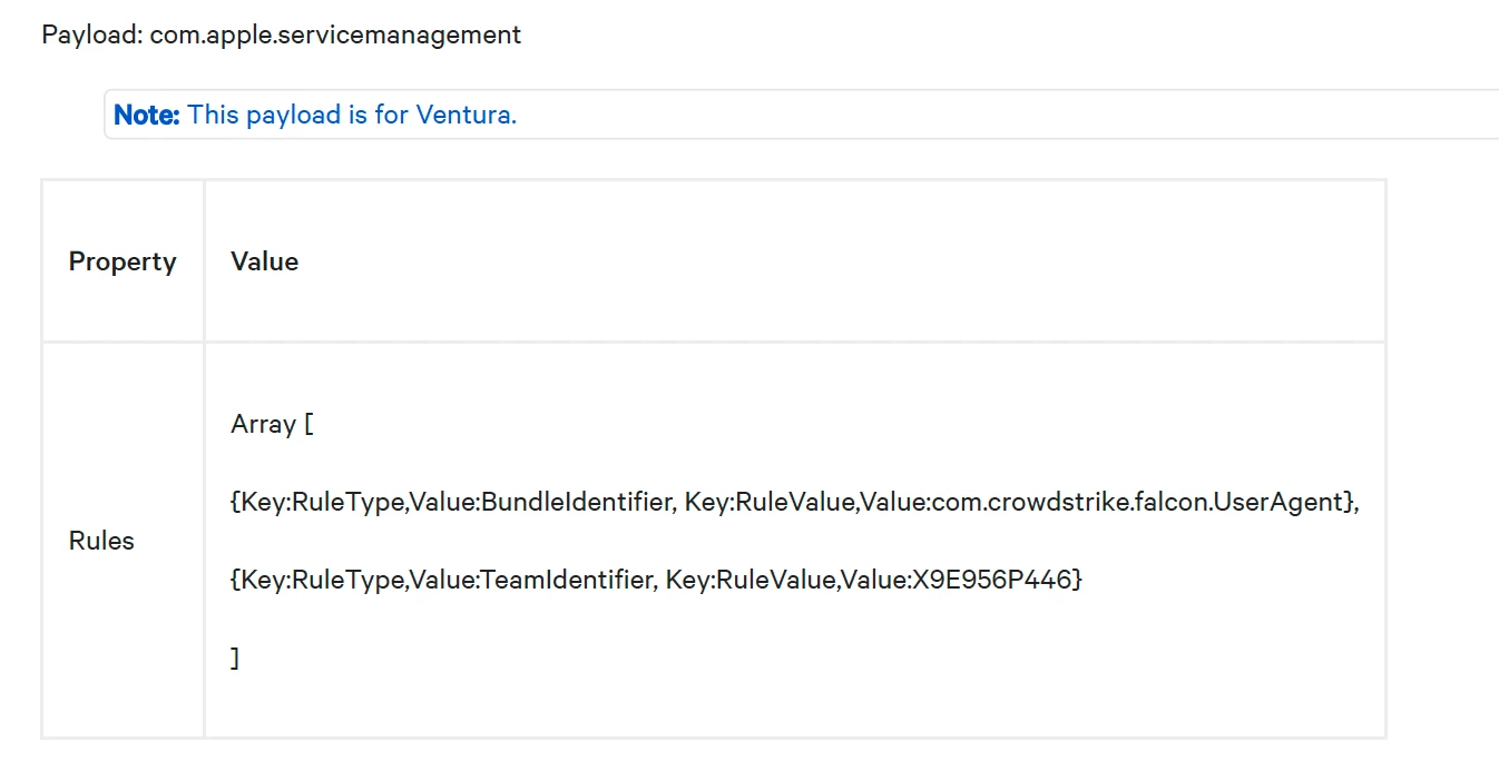

Has anyone been able to configure the Payload needed for Crowstrike to run with Ventura? (Screenshot attached it all Crowstrike's support continues to give me)
I have configured the system extensions as well as the content filter, but can't seem to figure this one out as they don't give much information. I've attempted to use PPPC-Utility as well as Apple Configurator, but they don't seem to work. As we have to go in and manually approve access. This is not ideal as it's our antivirus software and we'd like to have it up and running as soon as the device is enrolled.

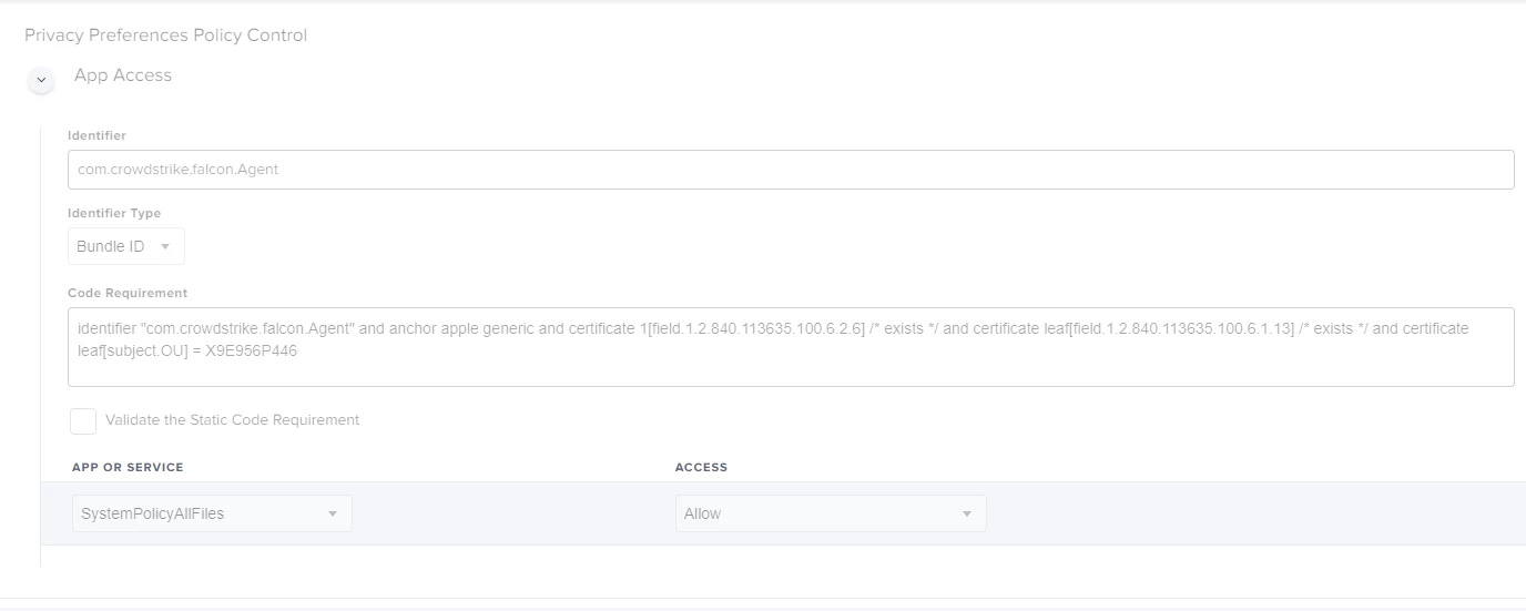

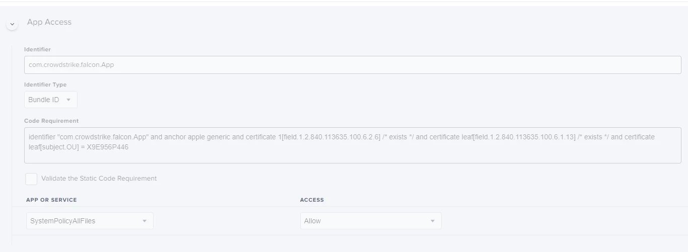

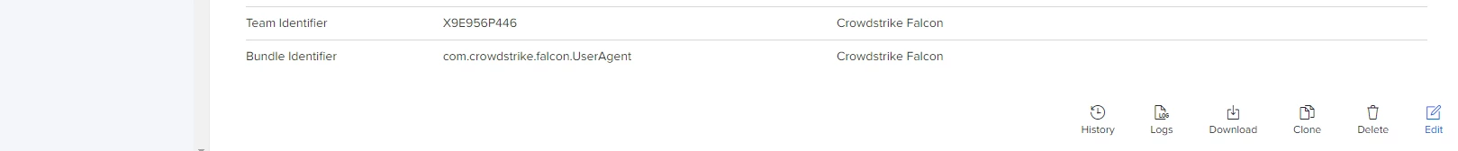

Here is what we did for the PPPC
I think the bottom thing you posted is the Managed Login Items section.  This is what we did for that so end users can't disable it.  Everything seems to be working with with those two things, along with system extensions, filter, and notifications configured as well.
