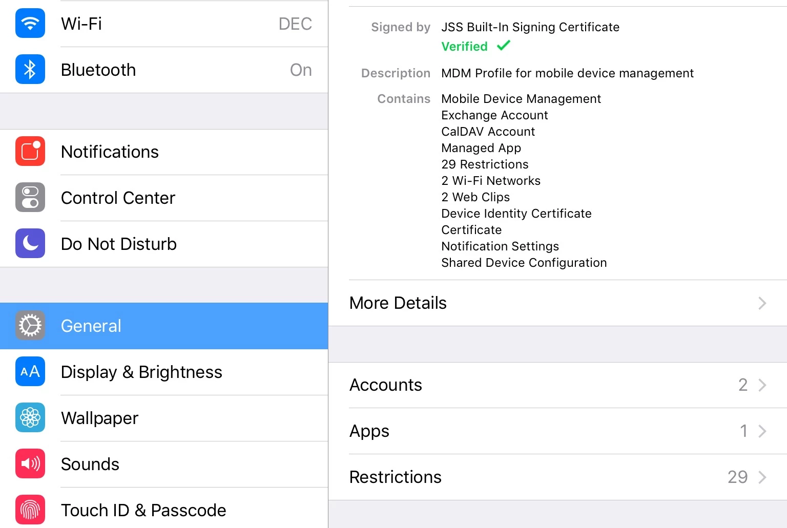

2) The lock screen payload I configured is not applying. I wanted it to say the "if lost return to..." and have our district name. However, it just has "this iPad is managed by.." and doesn't put that message on.

2) I have each one set as a separate configuration profile. It doesn't look like it's loading...or at least I can't see it listed on my list of management profiles on the iPad. I have attached a screen shot of my JSS profile list and a screen shot of what I see on the iPad.

2) My test profile for a Lock Screen is very simple and seems to work. Please post a screenshot of your profile?

2) Figured out the Lock Screen payload....working now.
