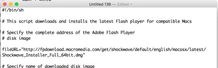

@nadams I think your problem in this case is how you copied the text of the script. it looks like you have a bunch of illegal characters including some carriage returns that show up like in "-noautoopen " (that is what the ' ') is in that command.
Did you copy this into a plain text editor?
This is what I would recommend you try. Copy the text of the script directly from what you posted in Jamfnation in your original thread into a plain text editor (remove the line with "fi" near the end of the script though). Textedit will do the trick, but you need to make sure its set to plain text in formatting (you shouldn't see any formatting bar in the document window):
If you do see a formatting bar, you can go to the Format menu and tell it to make it plain text. If it is already plain text it would offer you the option to make it Rich Text instead which is not what you want.
Save the script as a .sh, and run it with
sudo <your_username> sh /path/to/script.sh
Or, you can just download a copy that is working for me that doesn't have any weird characters in it from here:
https://dl.dropboxusercontent.com/u/519077/install_latest_shockwave.sh?dl=1
But I still suggest you give my other instructions a try as writing and editing scripts REALLY requires you to use a plain text editor and getting into that habit helps. :)
@chriscollins Thanks again for your help. I was already aware of the plain text requirement in scripting, and in fact had already copied the plain text from textedit, created a new file, pasted in plain text again and resaved. However that resaved file still had issues. When I copied from my original post above and pasted into a plain text textedit document and then saved it, it ran fine.
When is "plain text" in textedit not actually plain text?! I'm confused... but at least it's working now.

@nadams you might want to use a program like TextWrangler to do your script editing. Things like curly quotes which TextEdit likes to use can cause your scripts to not work properly.
@nadams Yeah, what @mpermann said. I never would suggest textedit for ongoing work but was just trying to suggest something you had already that you could get this taken care of with quickly :)
It looks like the find command is failing "$(/usr/bin/find $TMPMOUNT -maxdepth 1 ( -iname *.pkg -o -iname *.mpkg ))"
Something like /usr/sbin/installer -dumplog -verbose -pkg "$TMPMOUNT/*.pkg" -target "/"
I'd avoid using TextEdit entirely. Even when you tell it to use Plain text, it can occasionally still put some odd characters into the file that the shell will balk on.
My recommendation: TextWrangler is free from the App Store and is very suitable to writing or copying/pasting scripts and saving them as script files. As a few added bonuses, you don't need to make the resulting script executable before trying to run it (something you usually need to do with TextEdit saved script files), it has some great Find/Replace features, does nice syntax coloring to let you know if things are looking correct, and let's you run your script directly from the app without jumping out to Terminal. All good stuff, few of which TextEdit can do, or do well.
Just my 2¢
Edit: Looks like @mpermann beat me to the TextWrangler recommendation. But +1 to the recommendation. I obviously agree :)
I've had TextEdit still change single and double quotes in to smart quotes when the option is definitely unchecked in preferences.
Definitely worth avoiding it.
TextWrangler all the way, and the CLI tools let you run/test things in the app itself.
TextEdit is only a headache...

Anybody see why Casper Remote thinks this failed?
@nadams What version of the JSS are you running? There reason being that the text in your output has the word "error" in it and prior to JSS 9.82 the jamf binary would still report a policy having failed if the word error ever showed up in the output regardless of the actual exit status of the script or package.
@chriscollins That's pretty funny... However, my JSS is on 9.93. It looks like it only "fails" if I run it through Remote. Setting it up as an actual policy works fine.
Casper log is saying it failed because of this line:
Sep 26 13:11:40 installer[6427] : -[IFDInstallController(Private) _buildInstallPlanReturningError:]: location = file://localhost
just add 2>/dev/null to the end of the installer line to redirect stderr
I just updated my Flash "latest version" installer script if you want to throw that up in your JSS. I typically do the OS version check on the JSS rather than in the script.
