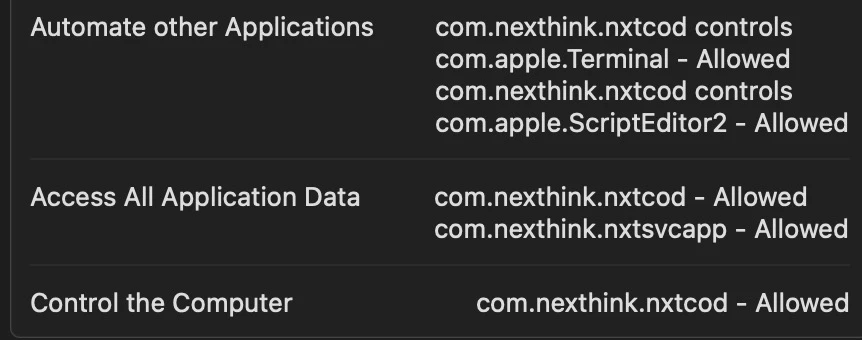

We had a similar issue when installing Nexthink on Sequoia devices. We had to update our PPPC configuration profile to give nexthink a missing permission.

I know the only thing we have in our current pppc is to allow nxtsvapp and that worked fine with sonoma and prior OS's. We also package the installer via composer and use a post install script for the install. I added the nxtcod to match what you had, but not having any luck with it reporting in the nexthink console. I'll do some more testing.

@SMR1 I just checked our Nexthink PPPC settings, which are working on macOS Sequoia, and it's just SystemPolicyAllFiles Allow for nxtsvapp.
