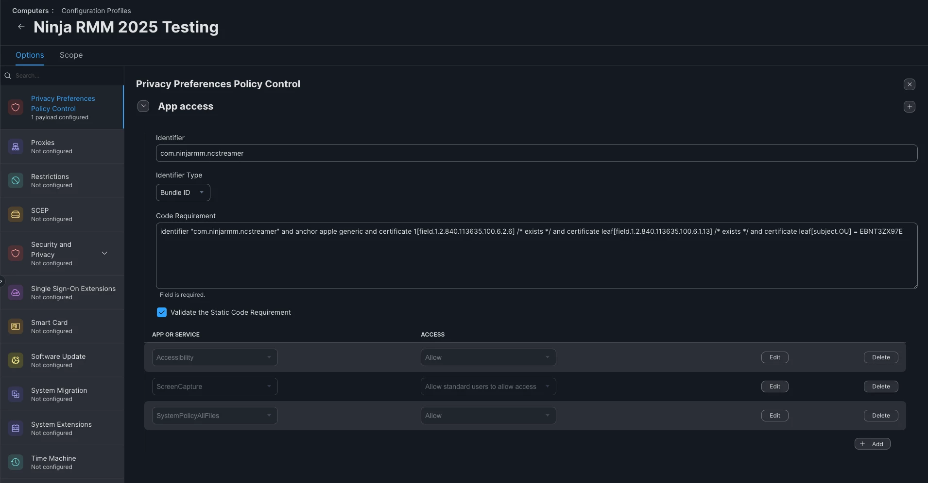

So this is kind of a two parter, the install via script showing up in the ninjaone dashboard and then configuring either the PPPC or KEXT exception in JAMF.
Did they answer the second part of this?
qroberts
  • Sep 29, 2025 12:55 PM UTC
I have been having trouble configuring the PPPC for NinjaOne using Jamf, none of those settings are applying correctly for the Ninja agent in the macOS PPPC settings.
  • Sep 29, 2025 1:48 PM UTC
Same, the only sqlite doesnt seem to be functioning correctly to create a KEXT.
  • Sep 29, 2025 7:32 PM UTC
Hmm, no the PPPC policy was not really addressed. I just used one that I have from a previous deployment. I noticed it doesn’t do much, either. I still get notifications and things seem to pop up anyway so I don’t think it’s very effective. Mostly I just tell people to click through any notifications or I am the one who sets up devices and I clear them off.
  • Sep 30, 2025 3:56 PM UTC
If you're using the PPPC Utility from GitHub (https://github.com/jamf/PPPC-Utility), follow these steps to configure Full Disk Access for the NinjaRMM Mac agent:
  1. Download and run the PPPC Utility.
  2. Click Add to create a new configuration.
  3. Use the shortcut Command + Shift + G to open the "Go to Folder" dialog.
  4. Navigate to the NinjaRMM Mac agent binary located at:
    /Applications/NinjaRMMagent/programfiles/
  5. Select the ninjarmm-agent file. The utility will automatically populate the entry.
  6. Set the access level to Full Disk Access.
  7. Save the configuration profile.
    • Note: You can sign the profile, but it’s not required. If you do sign it, Jamf may display a warning upon import and provide an option to strip the signature.
  8. Deploy the profile by assigning it to the appropriate scope in Jamf.
So far, this method appears to be working as expected.
