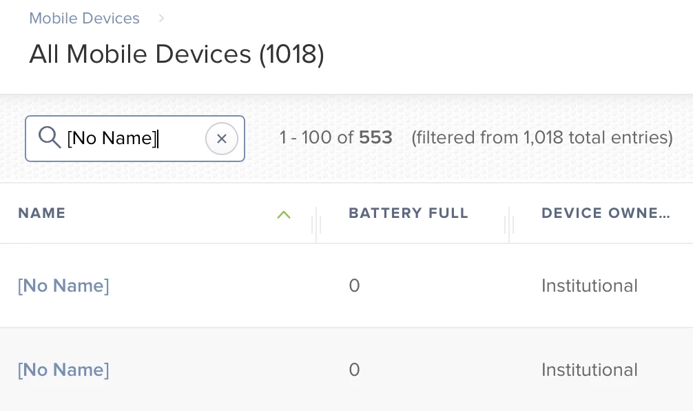

Am experiencing a similar issue but with mobile devices, cleaning up JSS have found 500 + devices with aforementioned [No Name].
Appears these are old assets, is there an easy way to remove from JSS?

Forum|alt.badge.img+15
  • June 28, 2018
When a computer is first added to the JSS, it shows up as No Name. Then as inventory/recon runs, the computer record is filled in. The No Name should be replaced within about 5 minutes - maybe 10 if you've a busy server. If it's longer than that, then something isn't right - perhaps enrollment failed and a new record was created when enrollment tried again?
