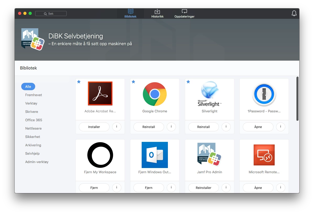

Hello,
With the new and better-looking Self Service in Jamf Pro 10, we decided to also add a Norwegian translation. I have sent it to Jamf for revision and possible future inclusion in the app, but for now I can provide two options to have your Self Service.app work in Norwegian.
Above is a screenshot of our Self Service.app, complete with Norwegian language and company branding. –Yes, there are two "Reinstall" strings missing a translation. This is because I haven't updated the JSS policy with the correct wording, not an error in the translation files.
In case some of you see the need for this, I give you the means to get a Norwegian Self Service.app for your own Jamf Pro setup.
1. Manual installation
Download and unzip the no.lproj folder from my OneDrive. It contains three .strings files that provides the needed translation texts. Place the folder no.lproj inside the the Self Service.app (use Show Package Contents on Self Service.app in Finder), as
Contents/Resources/no.lproj
Start Self Service on a Mac with Norwegian locale to use it in Norwegian.
2. DMG installation via Jamf Pro
Download the DMG from my OneDrive. This is a Composer DMG that will install the same no.lproj folder inside the Self Service.app (provided it is located in /Applications and is named Self Service.app).
Upload the DMG to your JPS Packages and make a policy that installs it on your client/test computers.
