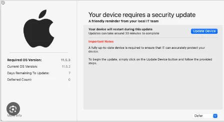

I was wondering if you can help me with my issue. So I'm setting up Nudge for my company and we decided to go with option 2 from the Github page. My objective is, I want the "Your Device Requires a Security Update" window to appear and to make this machine update when I press the update device button on the window.

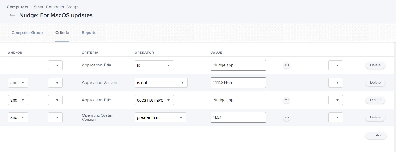

I have a test Mac with Big Sur installed Ver 11.7. I was able to set up the policies for the Nudge suite to be installed automatically to my tester which showed in Self Service as 'installed'. I was able to set up the configuration profile which the test Mac is part of. My question is, (Which I believe is the issue) setting up the criteria in the smart group. I set the criteria the same way as in the github page suggested but it's not finding my test mac. It shows 0 computers in that group. I was wondering if you can help. I will attach screenshots of my configuration.

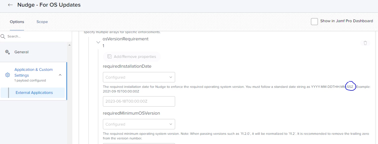

One more question: In Application & Custom Settings - under the requiredinstallationdate dropdown, what does "SSZ" mean? Do I need to enter an actual timezone like PST or EST on that string? Please let me know, thank you Jamf Nation!

@rdeleon If you're referring to the "Update Smart: Nudge" Smart Group definition shown on https://github.com/macadmins/nudge/wiki/Jamf-Pro-Guide#option-no-2-configuration-profile-standard-approach you missed the ( and ) that are shown in that Smart Group definition, and it's supposed to be "OR Application Title..." on the 3rd line of the group criteria.
For your question on SSZ the SS is the Seconds parameter for the time, and the Z refers to "Zulu" or UTC time so you need to adjust for the difference between UTC and the time zone you're wanting to use for setting your deadline.

Yes, that was it. Now, I see all of my machines in the smart group. Also, I had to adjust the time on the Application & Custom payload which I changed before I posted on Jamf Nation and left it overnight. I'm not sure how missed the "Or" but thanks for the help @sdagley
